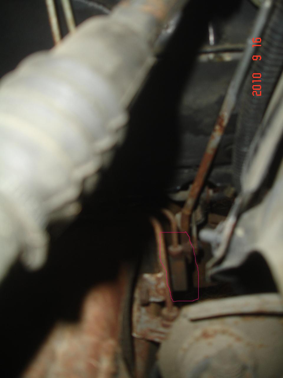

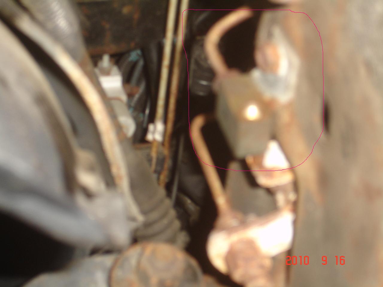

I took a couple pictures of the block on my truck, although not the best, but good enough to get an idea of what I'm talking about. Also copied the picture from NAPA Online, that the part number crossed to. Same as O'Reilly's... NOT what I need..!!
So..., wondering if someone has a factory parts # manual/catalog, to help me find the proper number for this block. It is basically a 90º female el. It is attached to a steel mounting bracket, with two bolt holes, that secure it to the frame.

Thanks Diefenbaker..!! You are the man..!! Took me about 5 minutes to find the part. No item number, but there is a part number. Called another local dealer, and he found it in less time than that..., although they did not have it in stock, as it is a discontinued item. ( How sad...)
He did however do a dealer inventory search, and found one about 70 miles North of here. Called them, and he had the part in hand, and gave a description. Exactly what I need..!!
