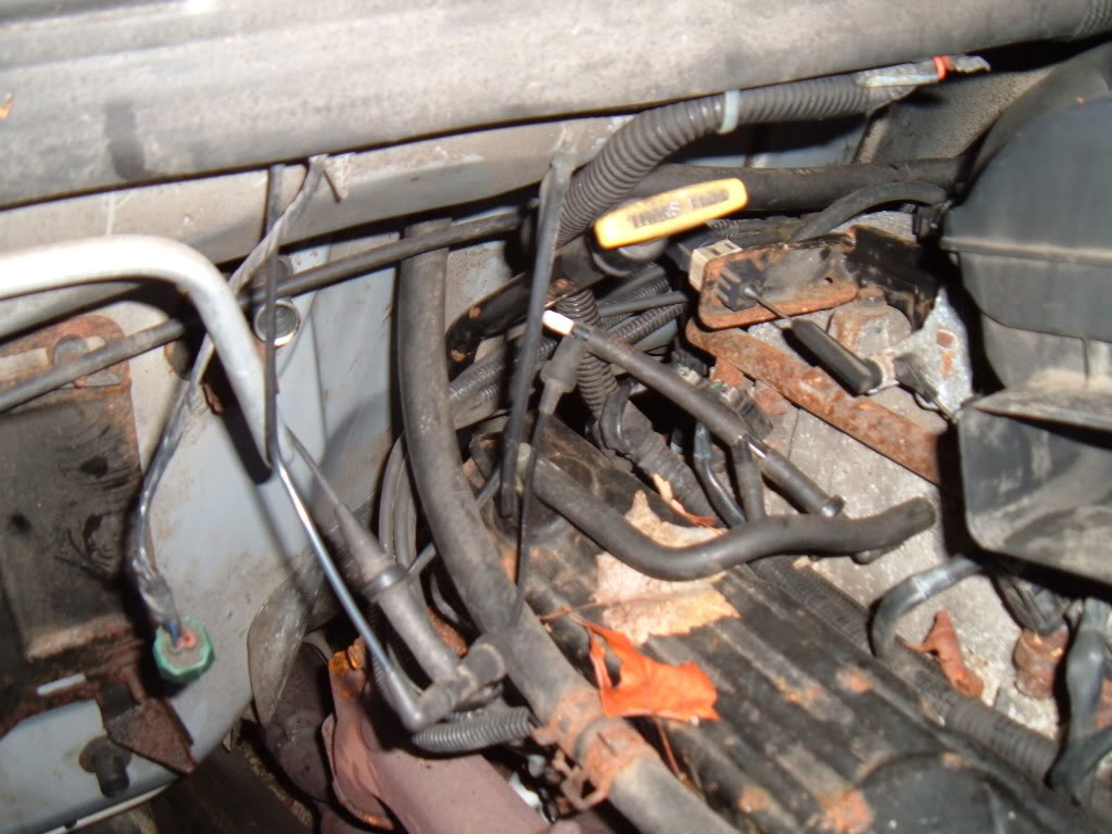

Neither of those 2 lines go into the firewall, the white one connects to the vac lines on the passenger side of the manifold, the green one is just a vent and should have a check valve on the end of it.
In this pic you will see a white rubber cap. That is where the white line connects to.
