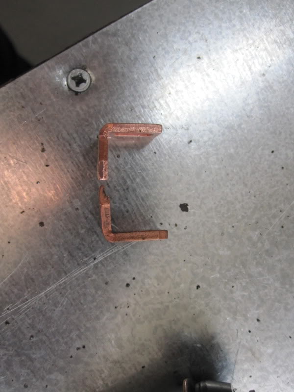

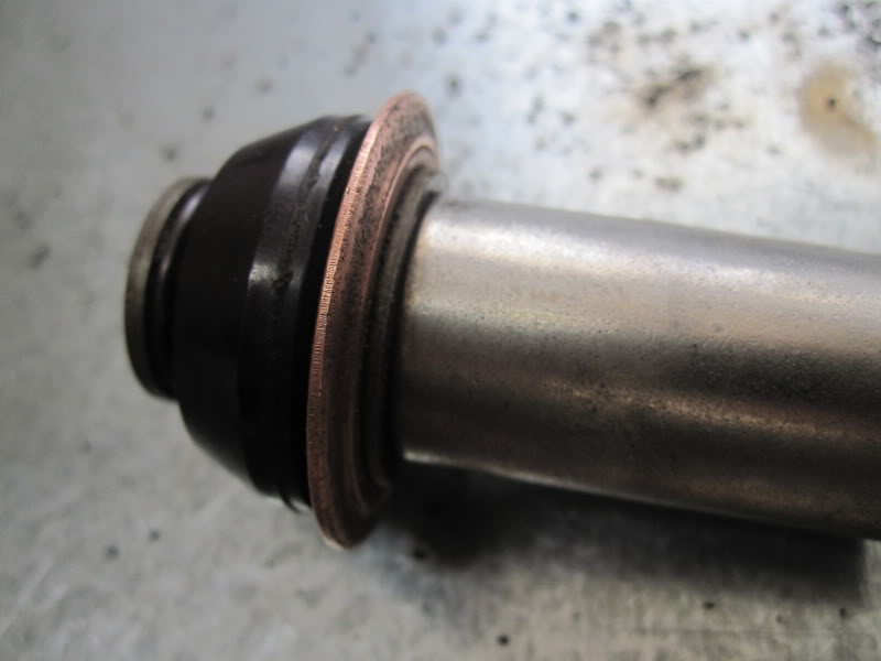

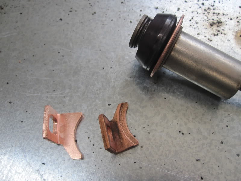

The grooves are not supposed to be there though they look like they were supposed to be.
