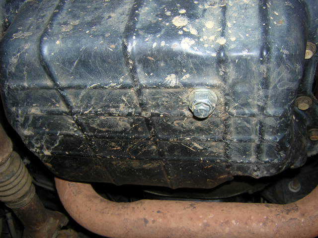

here's the part numbers for the universal type plug that you can install in the stock pan.
https://dodgeforum.com/forum/2nd-gen...drainplug.html
use a 1/2 inch drill bit and spend some time placing the plug. you'll need to place it in the center of a stamped square, on a flat spot, either low on the side or on the bottom.
do NOT install it where it will hit the solenoids in the rear of the pan. the plug and nut protrudes a little into the pan. you can cut off the excess if you want to spend extra time with it.
i placed it in the bottom on my truck, but on the side on the jeep.
