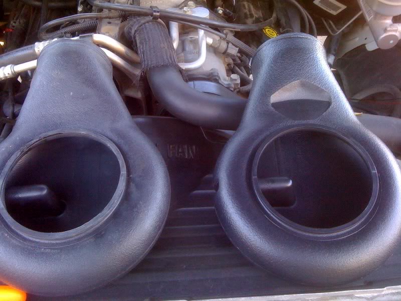

There is a thread about it some where but Im too lazy to look for it. A member here discovered that the first kits that were made I think before december of last year have a problem with the air hat. the airhats themselves were blocking the truck from hitting WOT. Spectre had to redesign the airhat with a notch in it so the linkage assembley could open all the way.Name:  photo1.jpg

Very interesting! I had no clue about that. How did you get go about getting the new one?

I just contacted Spectre Performance and after a couple of questions about the motor and my address they replaced it free of charge.
