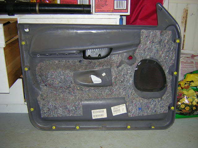

its not too bad to replace. buy a $5-10 door panel tool to pop the panel loose. remove the screws in the door handle, mirror area, maybe one more? use a plastic putty knife to ease the panel up and not scratch the door. also to slide back and forth to locate the clips. the door panel tool catches in the notch of the tree, and pops it out with no damage. slide a piece of cardboard under the tool, again to prevent scratches.

key pics from that thread.
