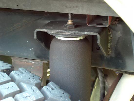

Timbrens are a big improvement over traditional "helper springs" which can be downright intolerable when driving around without a lot of weight in the bed.
But I like the versatility of air bags, myself. Even without messing with on-board air, it's literally seconds to adjust the air in them from a simple Schrader valve. When you run them with just enough air in them to retain their shape, you don't know they are there, when you need big time leveling, just put some air in them.
Commonly made for either 2000# or 5000# of leveling strength, I can't imagine anyone needing the larger. I've had 2200# of river rock in the bed of my truck and only needed 40% air capacity to keep it level, while 30% capacity leaves it level when trailering a 7700# tractor/trailer combo. I have 2000# leveling capacity Air Lift, paid under $200 for the kit and it took me about 2 hours to install it in the driveway.

It's not an issue for me, I carry a jump box with air compressor in my truck tool box, not to mention have a 110v compressor in the garage and a 220v in the barn at the farm. Also, I carry a small 12v compressor in my ATV with a tire patch kit (have had to use both on trail more than a time or two). So if I'm airing up to load the ATV, I can just pull the ATV up to the back and fill. The over-all volume of the bags is so small you can literally fill them from 10% to 100% in about 15 seconds.
Also, in my pic you may see that I welded the brackets on, you do not need to, as per the instructions you can bolt them on with the supplied bolts. I just chose to weld them.
Every load equaling system has pros and cons. I've done add-a-leafs before in other trucks I've had and know a couple of people with the Timbrens. In farm country Georgia, it's very common to know people with some type of system on their pickups. I've just found the air bag system I tried with this truck to have the least amount of cons, only ones being you need an air source and I guess the possibility of a bag breaking, which you almost never hear of.
On-board systems are great, if you use the bags regularly, from manual, in-cab, push a button right up to completely automated load leveling depending on how much you want to spend. I just don't use mine enough (maybe 6-8 times a year) to justify the expense...
