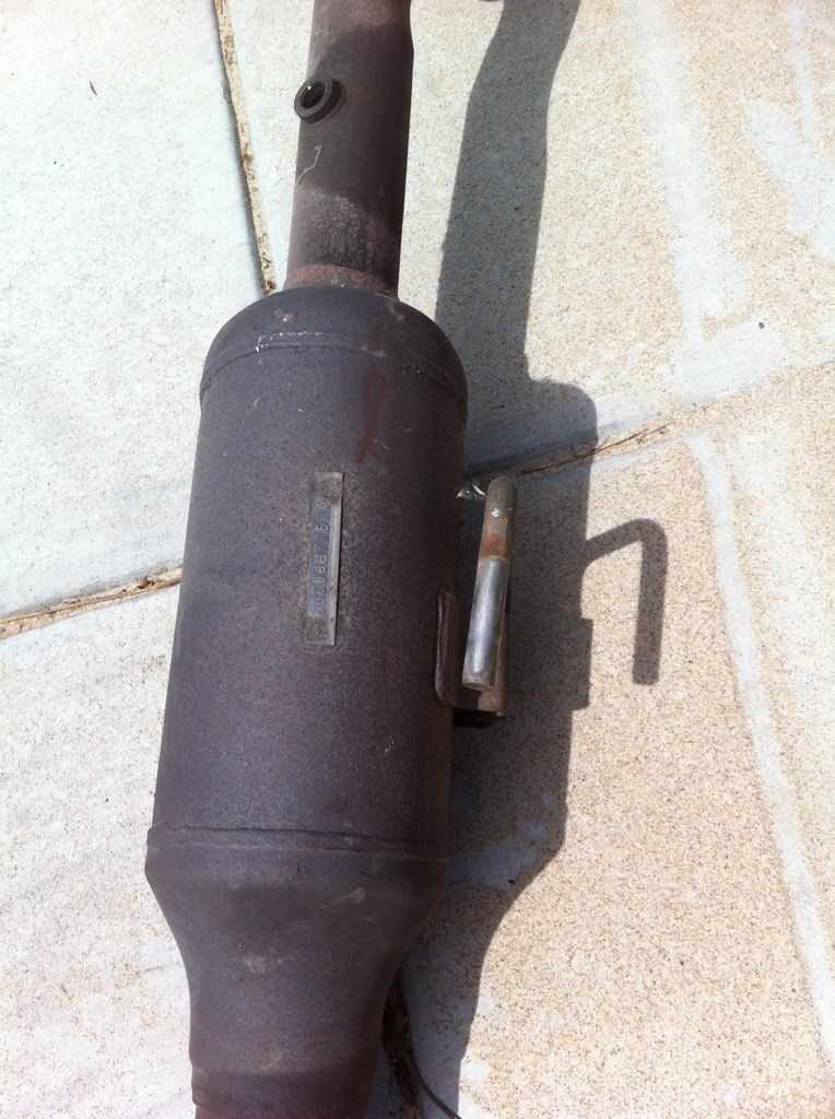

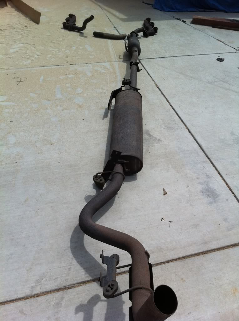

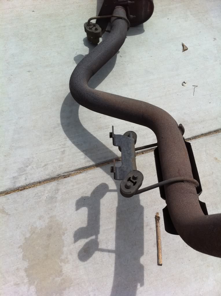

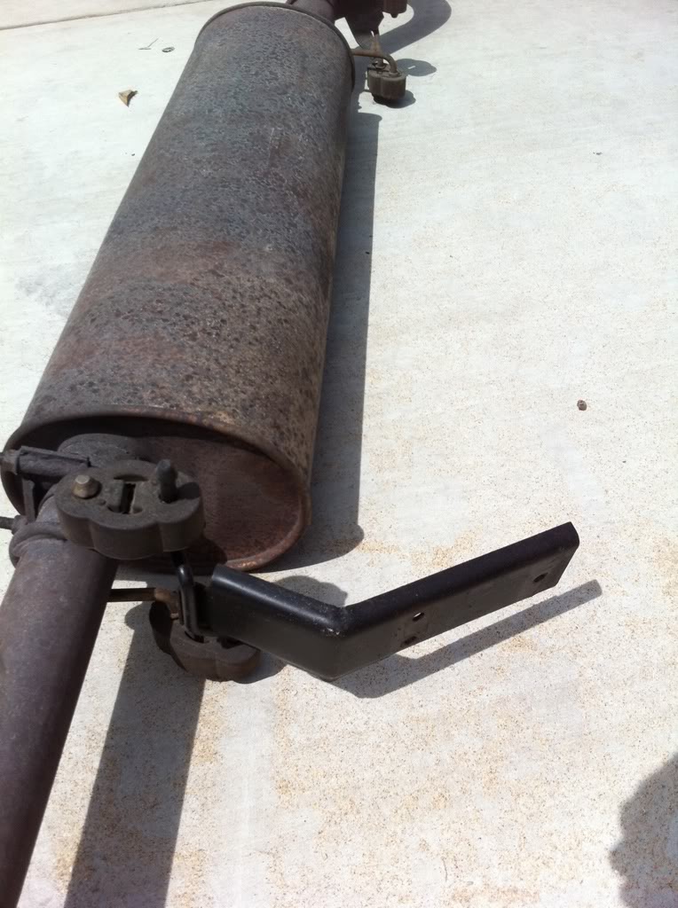

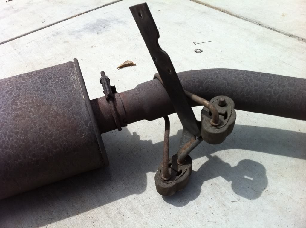

heres a pic of the stock exhaust / brackets. hope this helps.
