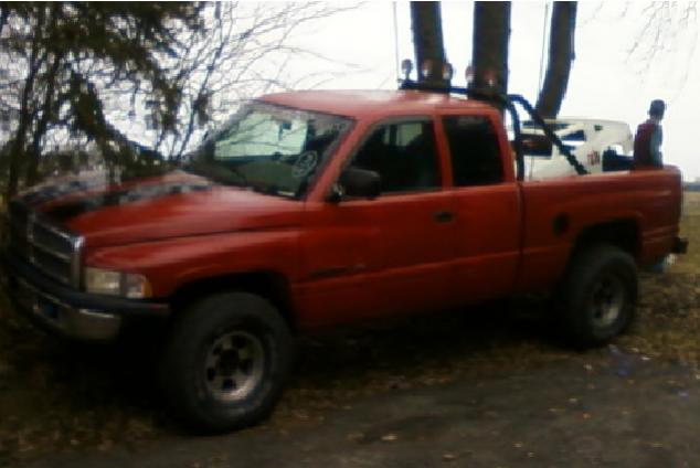

thanks for all the info and i am seriously thinking about going with the 120 amp, if it is not much more in price than the 90 amp, exspecially since i have the extra lights on the back as you can tell from my pic going to go price them today i will post later on what i end up getting and if i find out what the numbers where it may come use ful to some one else that had same problem as me hopefully!
