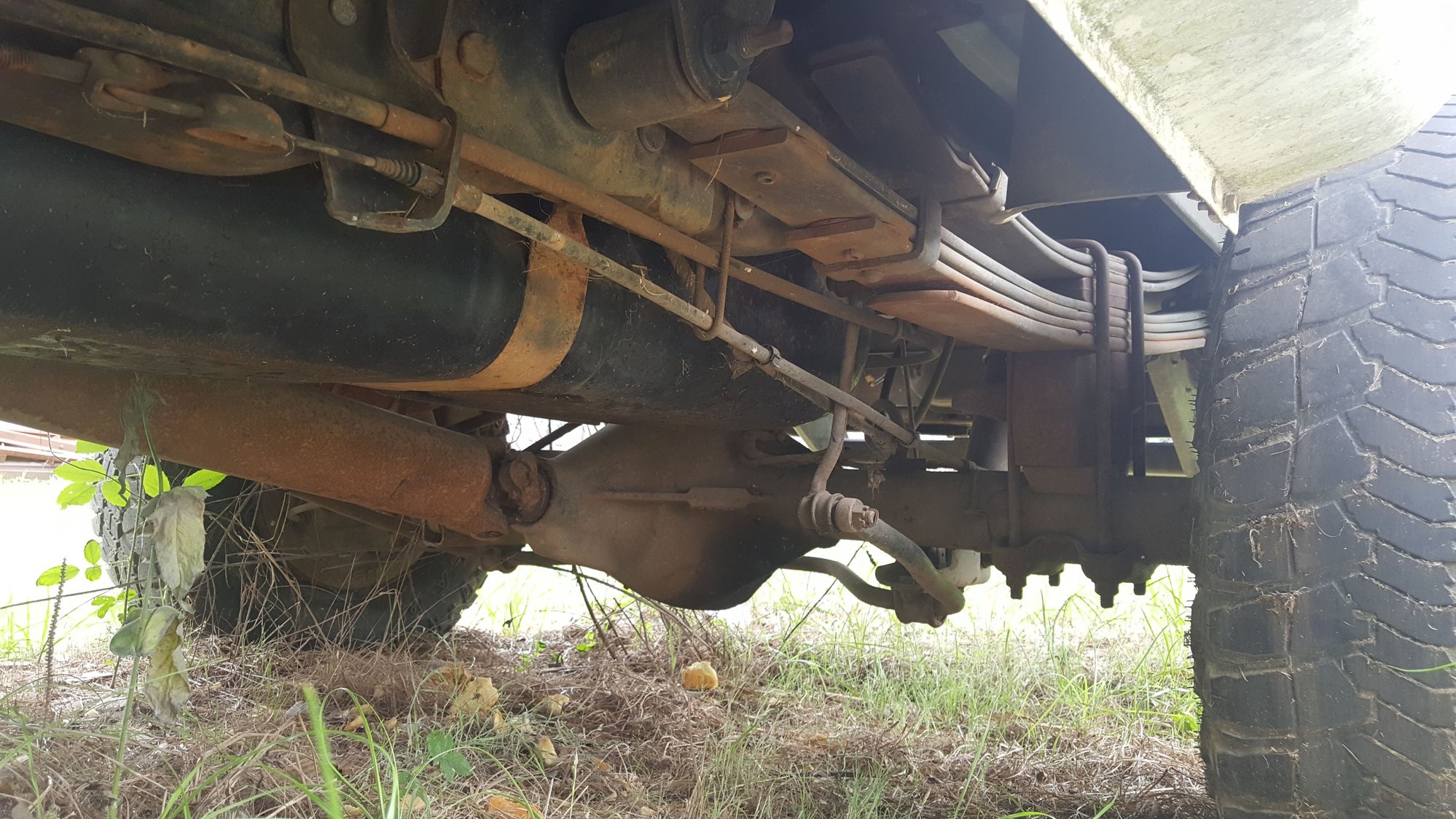

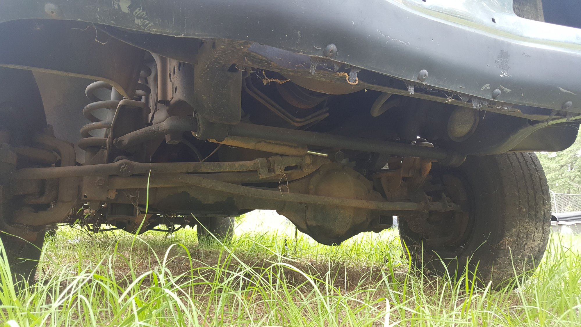

So I bought a 97 2500 to do my swap as well. What is some insight on using stock 1500 drive shafts, but modified yokes to work. It would be nice to just swap the transfer case, but I fear input shafts are different. Could I junkyard search 2500 ext cab driveshaft and be done? Parts truck is a 5.9 as well. It would be sweet if I could swap transmission and transfer case, but I'm not exact about adding in the 98 electronics to the older tranny.
I am gonna be curious as how much extra lift I'm going to get with the helper springs. All the perches, helper spring stops and all, I was planning on unbolting and bolting up to the 1500 frame.
