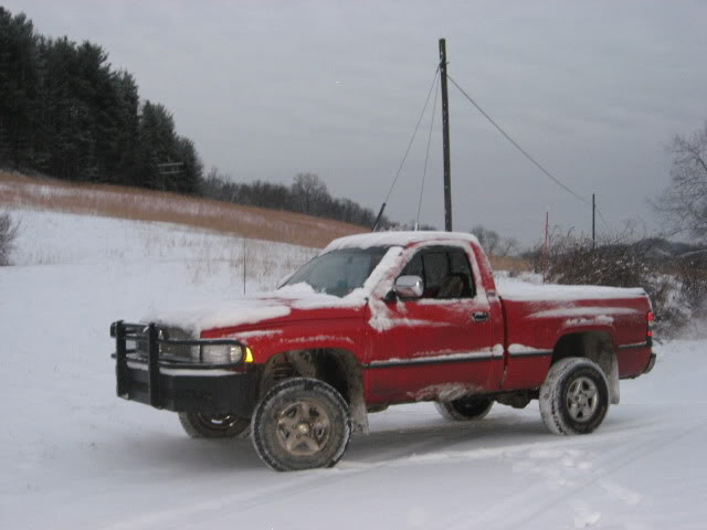

this is my front bumper
build out of 2 1/2in od 1/4in black iron
the upper cross bar is 2in od. i have since added a V from the lower bumper bar back to the forward frame cross brace. its the same 2in od bar is the cross bar. i plan to use it for a winch mount. going to install a 1/2 or 1in plat thats going to be mounting to the V via weld and im going to solid bolt the plat to the V for extra support
i used 1/4 in peice of flat stock and also a piece L angle that i welded together so that way i did have a weak point i didnt want to build a battering ram. just incase something does happen i dont wanna kill anyone.
