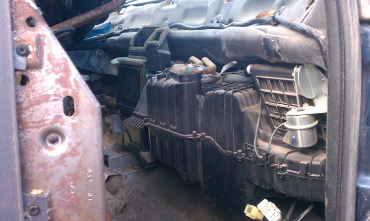

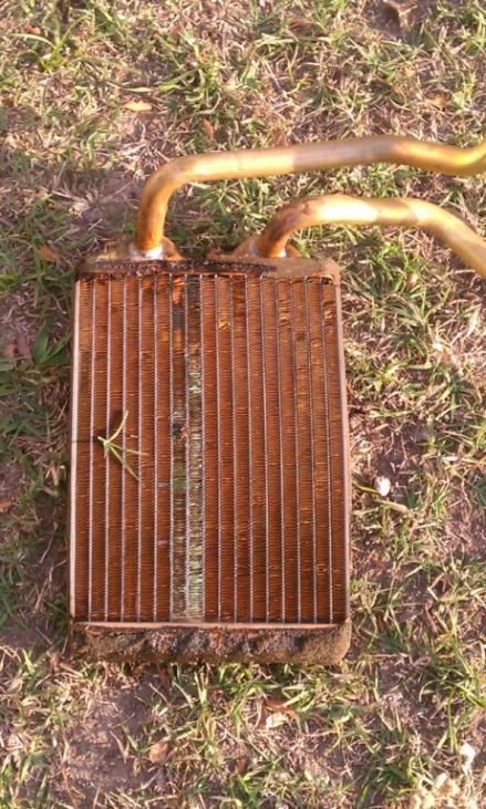

tbotello's Avatar
tbotello
Joined: Feb 2008
Posts: 17
I did mine this past weekend, it wasnt so bad. I also had to repair some vacuum hoses I snapped in the process.
Attached Thumbnails Heater core done! works great!-imag1058.jpg   Heater core done! works great!-imag1059.jpg   Heater core done! works great!-imag1060.jpg
