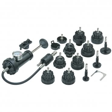

Radiator pressure tester? Pressurize even cold, and able to measure how fast it leaks down.
