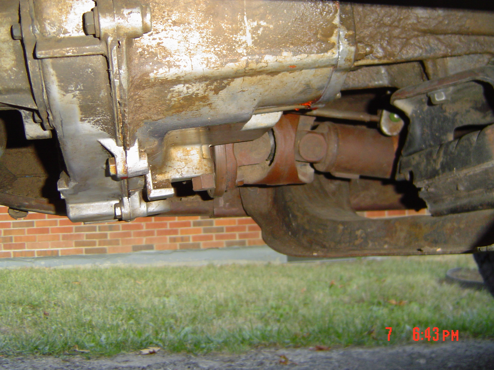

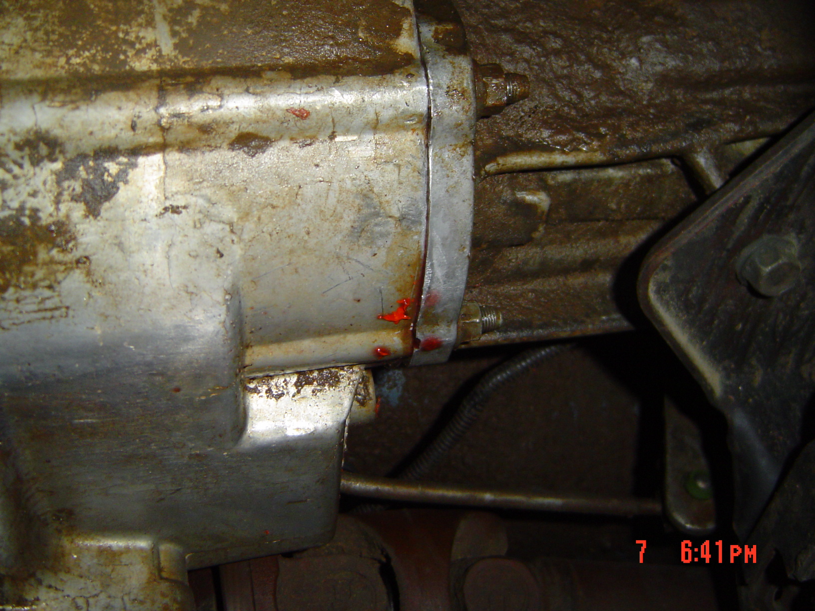

Okay, I've attached a couple picture to make sure we are talking about the right seal. If we are, the only fluid that will drain out is the transmission fluid - right?
Is there a drain plug or just unbolt it like i'm dropping a transmission pan

Dude your transfer is fine. The seal that is leaking is where your tranny and transfer bolt up together. unbolt it, drop the transfer, clean off both surfaces real good, then throw a 1 inch bead of silicone on both the tranny and transfer. You will have fluid come out the transfer and tranny when you drop it. They use the same fluid. You can drop it like it is but you will make a little bit of a mess. Just make sure you fill up your fluids when your done. but yeah, your transfer is fine. Its just the seal where they hook up. The nuts on top of the transfer are a pain to take off. Make sure you torque them down. 1500 4x4 5.9 2001 monster
