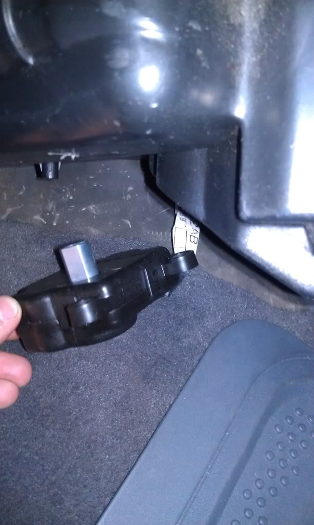

Here is the Acuator:

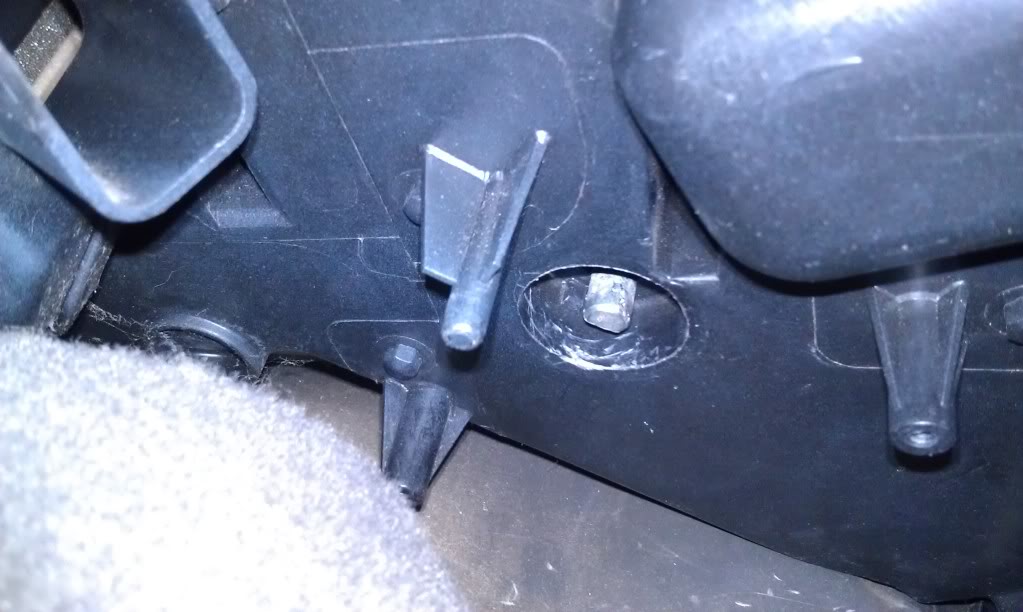

Here is the shaft the the acuator turns to rotate the blend door:

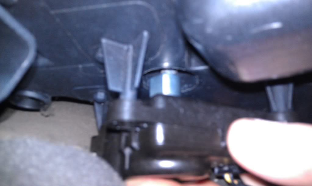

Here it is mocked up:
As you can see, the acuator does not sit flush enough to twist the shaft. i believe i am missing another piece between the acuator and shaft. can someone confirm this for me, and perhaps point me in the direction towards finding a new what ever it is i am missing?

You need one of these. It's better than the factory plastic piece. http://www.heatertreater.net/magento...ram-95-02.html

Thanks man. i just ordered it. so that black piece is the piece that i am missing correct??
Old Apr 10, 2012 | 04:23 PM
zman17's Avatar
zman17
Retired Moderator - RIP
Posts: 18,729
Likes: 17
From: NH
Yes, but the black piece is the OEM plastic POS, that's why you'll be getting a metal one when it comes in the mail.
