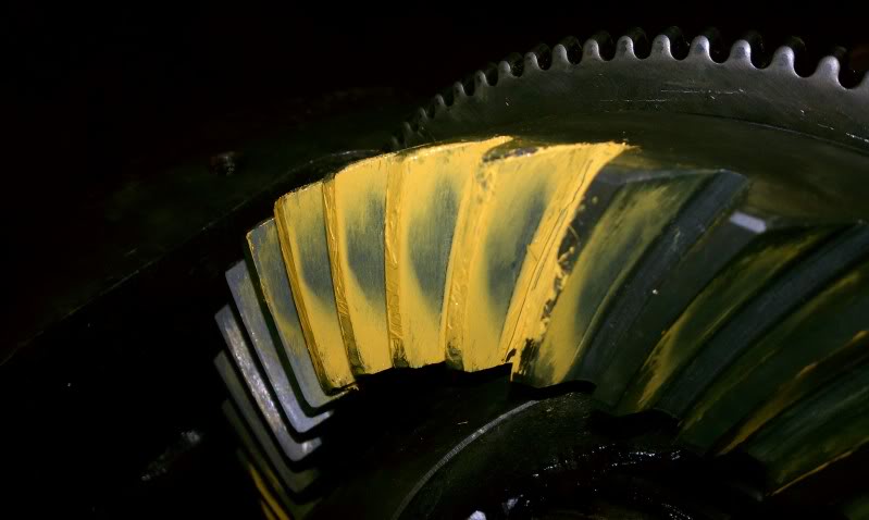

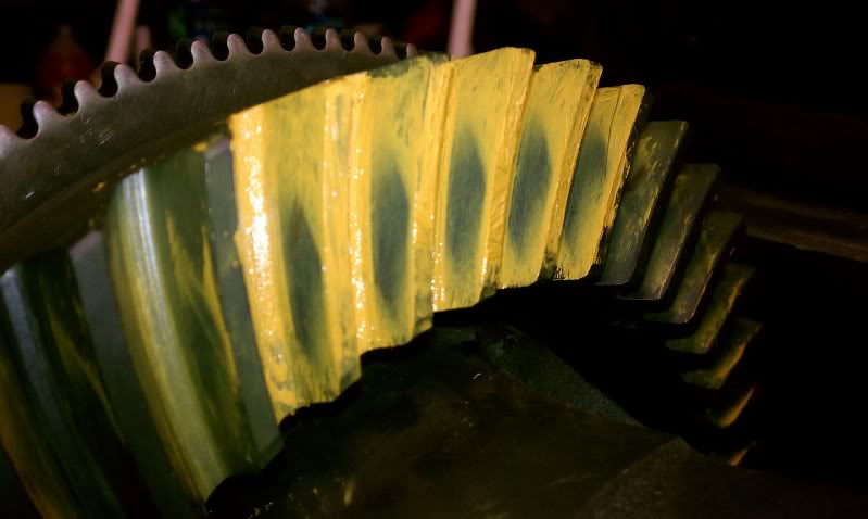

Working on my chrysler 9.25. My install kit limits my pinion depth options in that it only comes with 3x .008, 1x .015 and 1x .019 pinion shims in the kit. I've messed around with a few different extremes in shims .024 seemed to close to the face and .035 didn't look to be quite right. So, i have .031 for pinion shims and backlash set at .006 as stamped on the ring gear, pinion preload is at about 18-19in/lbs rotational drag. Does this pattern seem acceptable, all the images i find online don't look very clear.
