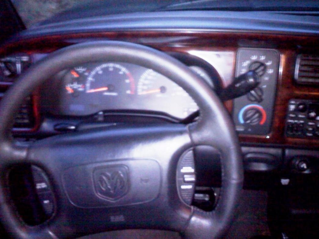

Oh yes I do know that since the truck I used to swap my manual was from a 95 and my 2500 was a 99...
Attached Thumbnails 95 Dodge Ram 2500 4x4 V10 eng plow truck-dash2.jpg   95 Dodge Ram 2500 4x4 V10 eng plow truck-picture-173.jpg
