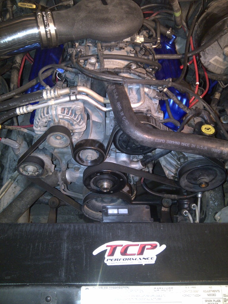

I cannot receall exactly, but I don't remember if the hoses can be deisconnected from the fitting where they connect to the compressor....I'll go out and look later!
Found this pic....
Found this pic....
gdstock,
My leak is on the high pressure side just out of view of that picture where the metal tubing switches to the rubber insulated lines. Of course mine is a V10 so it looks a little different.

Did they give an estime of the cost to repair the leak, depending on what it is of course....
As you look at the photo of mine, you can see the hoses are crimped onto the tubing, and each tubing piece is welded to the manifold fitting. I cannot imagine that a hydraulics place (tractor dealer) or someone could not replace the hose...crimp and all. Not like it is rocket science....
