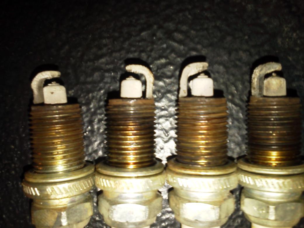

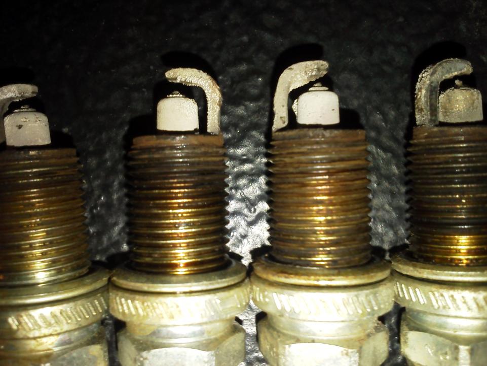

My cat was replaced just before i did the plenum. Should i still replace it? What happens to the cat with the bad plenum? I pulled all plugs tonight and they look horrible. Im not sure if it was caused from Pre-Plenum problems or not, but i kinda planned on replacing the O2 sensors soon anyway. Im gonna get new plugs and the O2 sensors and hope that fixes the misfire. When i get a chance I'll do some more searching on the vacuum leak.

Those are some nasty lookin plugs. Way overdue. Might as well go for wires, cap and rotor too.
