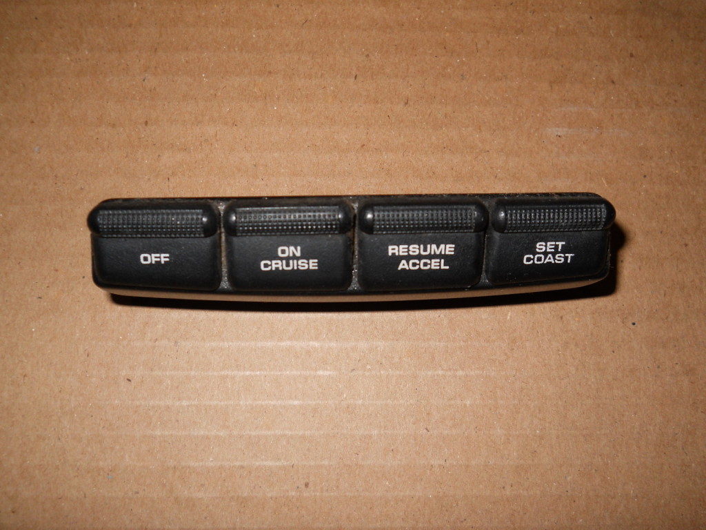

yeah, I've been looking at the wiring diagrams. Just was hoping someone would say "oh, thats easy, check x and replace y" kinda thing. Thanks for the link, but my cruise control buttons done look like those. Mine are in a row on the bottom of the wheel.

Just do search on e-bay. I used 99 out of habit! lol......
Does it look like THIS?
Zman makes JY runs pretty often and has a JY thread. He may be able to find it for you.

Yeah thats it. I searched on ebay as well. I was asking how it comes out.
There are two screws behind the steering wheel. Unscrew them, then pul the switch and the connector. No need to remove airbag, but to be on a safe side, disconnect the battery before working with steering wheel, it's not fun to get airbag blow up on you.
