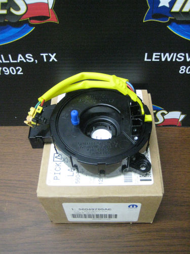

Hello all. I am trying to swap a 3rd gen steering wheel w/cruise and functional airbag into my 2nd gen 1500 2wd. I am doing some research to see how the airbag system works on the 3rd gen as I believe the 3rd gen has the newer style airbags.
So far I know the 3rd gen has the airbag, clock spring, and airbag module. How does the 2nd gen (97 to be specific) air bag system work? I assume they have the older style airbags. Is there an airbag module in the 2nd gens?
I have attached a picture of the 04 airbag and clock spring for reference.
Thanks,
Mike
Attached Thumbnails Airbag differences from 3rd gen-04-09-clock-spring-front.jpg   Airbag differences from 3rd gen-04-airbag-back.jpg

The 2nd gen does have an airbag module as well. I cannot attach more pictures but between the 2nd and 3rd gens, the steering wheel, airbag, clock spring, and airbag module are all different and would need to be swapped.
Now the question is, what are the pins on the airbag module connector? and can it simply be a connector swap. This already looks very involved and may not be worth it anymore.
