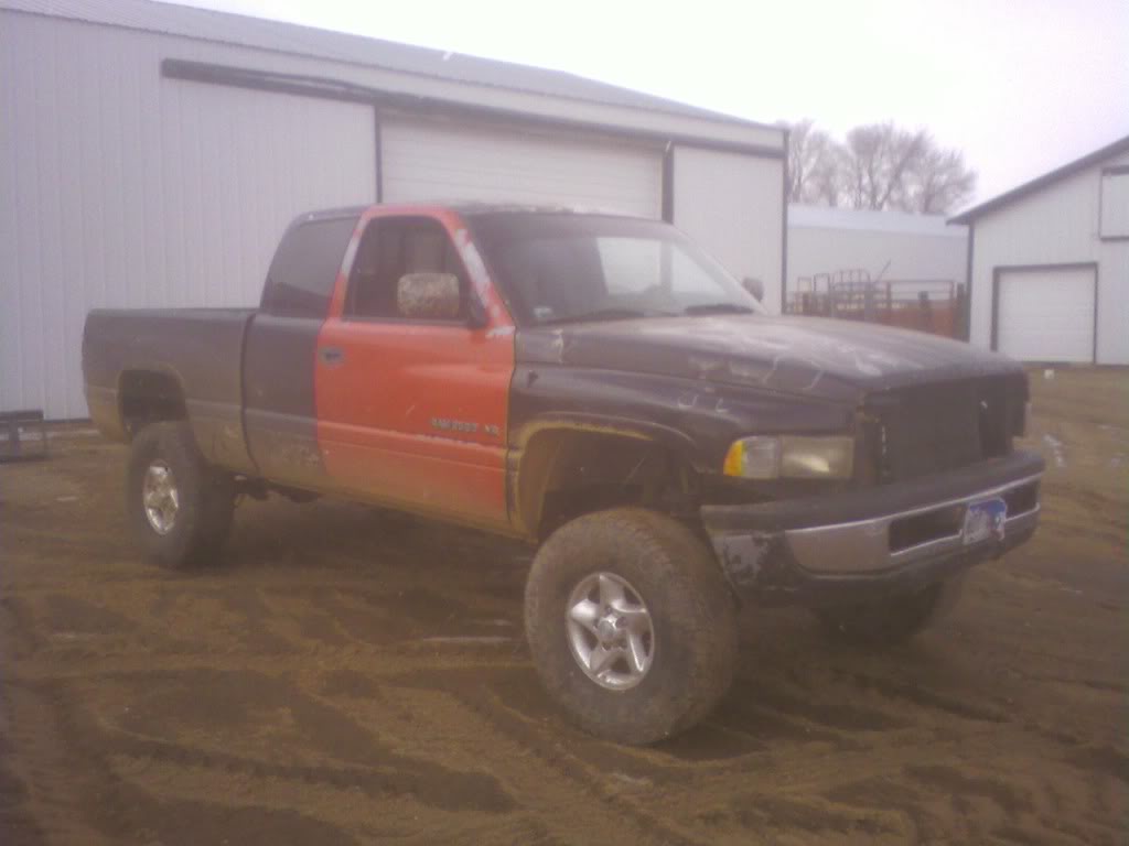

well plans kinda took a turn, axle came in for that tractor so spent the weekend 2 weeks ago putting that in and getting it out of the shop, then last weekend had some other stuff goin on too, but found some time to work on it, got some used 35s stuffed under it and im liking the look, need some hub spacers though cause they fight with the control arms, put the front coils off the red truck under it and gave it some boost up front, trying to track down a new front bumper now

Wow. What did the donor look like..........

Donor was a pile lol, hood and roof had hail damage, doors seem ok though, paint peeling bad on the rest of it. Besides motor and hood rest of the front was gone when i bought it. Drivers side of box was smashed in, tailgate beat to heck and smashed, interior was horribly inhabited with mice. Seat chewed, wiring chewed steering wheel just plain wore down to the steel. Doors even had rats nests in them made from the sound material, but good thing they were all manual so i just transferred wiring from black doors into red ones when i converted them. thats just to start lol
