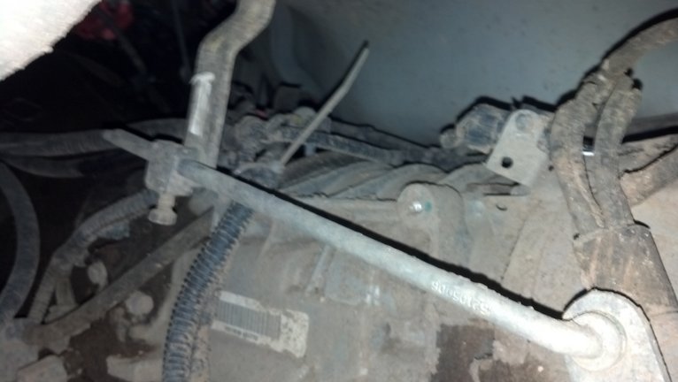

It really doesnt take much effort for shifting to 4x4.. barley any at all.. I would start taking a look at your shift linkage to see if there is any binding going on.. And the t-case does take atf +4 like the transmission.. Just beware that the drain plug and fill plug tend to not want to come loose..
Thanks. It isn't that I thought the shifter moved hard or anything, just that I was pi$$ed and decided to give it a good yank. The truck only has 65k miles on it (my dad drove only a few miles each day to and from work) so while that doesn't seem like a lot on the fluid, I was just thinking heck if it is the original fluid, why not get it changed. Does looking at the shift linkage require disassembly of anything or if I have it up on jack stands, can I see things pretty clearly if someone is moving the shift **** in the truck.
You can just lay under the truck and be able to see it.. It could be out of adjustment or binding somehow.. Its a pretty simple setup.. If just shouldnt take that much force that you are explaining.. You should be able to reach down and pull it back with very little force.
I'd offer that the effort to shift to 4Hi is more than using the column shifter for the tranny.
It seems to me like your stuff is working properly from what you've described. Idk if mentioned but going to 4lo requires being in N and preferably not moving, then move tcase lever to 4lo. Shift tranny to 1st and easy. Just giving you a caution is all as I try to minimize grind as that can happen momentarily.
Good idea to get truck on jackstands to see the tcase linkage. No disassembly needed.
Here's a picture to help out.
Thanks. Hopefully the snow will stay away for a while as this weekend is likely the next chance I'll have to spend any time with it. The t-case shifting is "harder" than the tranny shift but I wouldn't call it hard in general. Seems smooth, no binding but clearly something goes askew periodically. Thank you for the picture.
