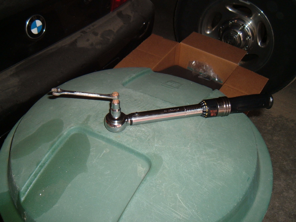

From: NH
The front/outside adjusting screw on a 98 requires a special socket, if you can even get to it. Here is the setup I used. And changed the torque value according to the manual (using the special tool) . Name:  DSCF0738.jpg
...by a factor 0d 30% or so.....
