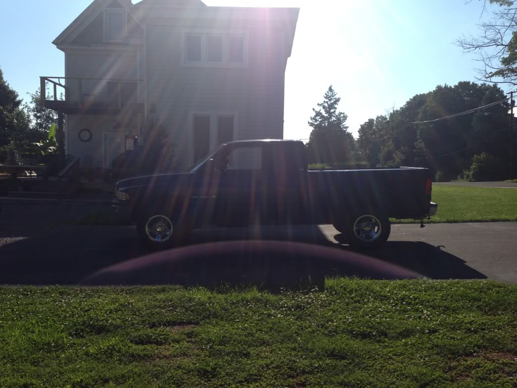

I have 2500 diesel coil springs on my truck. Added 2-2.5 inches. Cost 10 dollars less than the hell bent spacers.
And contrary to what everyone says it rides fine. It's still a Truck after all.
Lighting sucks but you get the idea
