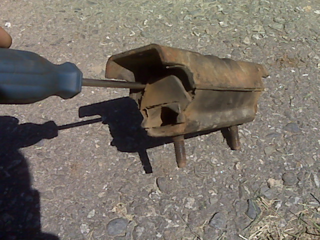

I have changed that same mount out twice not liking the movement it allowed, seems they are all like that. The first one the rubber had delaminated from the metal, the second was just to see if the dealer part was any better than the Lordco part.....nope. This is like a 15 minute job to change the tranny mount, 15mm deep socket, 5/8ths socket, bottle jack, piece of wood to protect the tranny pan and done deal.
Will this fix the vibe hard for me to say. I would still rotate the tires and have the balance checked on them, check the trackbar, all the tre's, and the unit/wheel bearings.
A photo of where it was delaminated.
