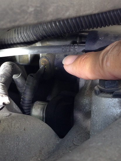

After searching the forums, I figure I need a new TPS, I went under the hood and after removing the air filter box cover, Top sensor is IAC and under that is the TPS. Remove Air filter cover and move it asside. Then with a 11mm socket remove the four nuts to remove the air box from trottle body. Remove the 3 prong cable from the tps. Remove the 2 torx head screws with a t25. assemble reverse order but ensure the inside female slot aligns with flat male rod that connects the butterfly vavle.

The TPS is on the drivers side of throttle body. The IAC is on the back side of TB toward the firewall.
Disconnect neg battery cable when replacing the TPS.

Readram, Thanks for the battery cable reminder. I decided to go for it and this is what I can conclude:
I went under the hood disconnected the battery Negative cable. The IAC is the top sensor on the trottlebody (TB) photo the one under it is the throttle position sensor (TPS). Need to remove the Air box cover and filter and move them aside. Then remove the four 11 mm nuts to remove the airbox from the TB. Now unplug the three prong connector form the TPS. Using a t25 remove the two torx head screws. Refit is reverse order, but ensure the female connector is aligned with the flat make protrusion of the butterfly valve shaft.
