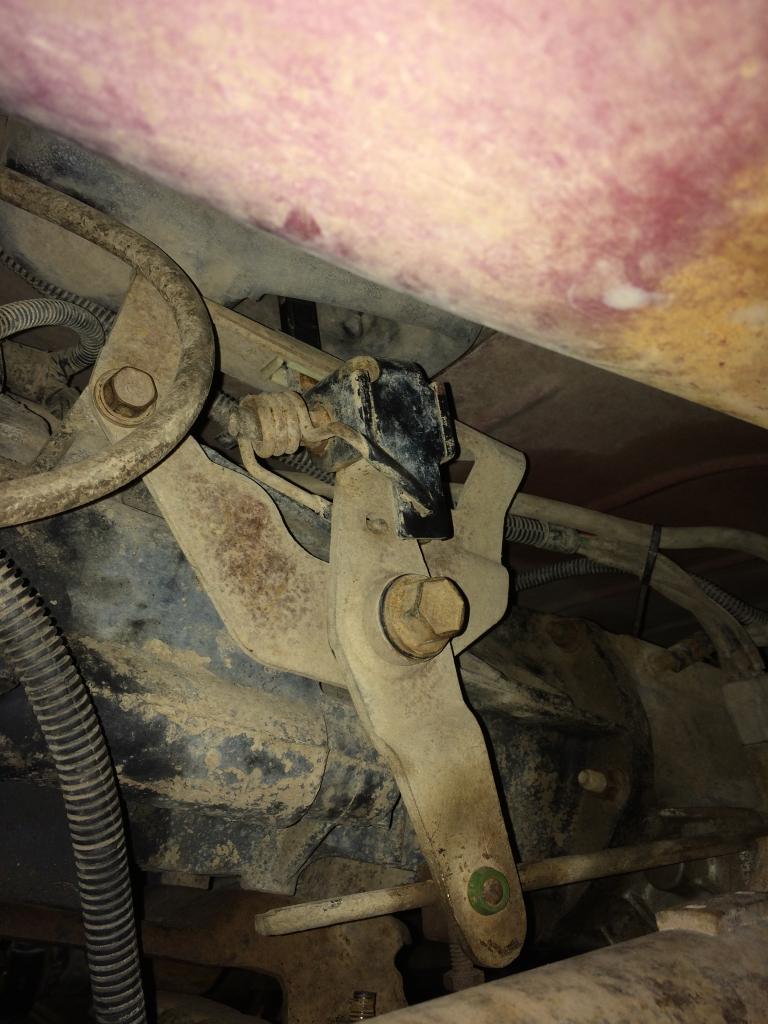

Originally Posted by Wh1t3NuKle
The motion looks normal to me.
The shifter is mounted to the body. The linkage is connects to the shifter and then tranny tab. That is how on the 00 at least and presumably on the 01. Different on other years...?
Here's the shifter on my 95. Seems like a better design to me to have it mounted to the transmission.
