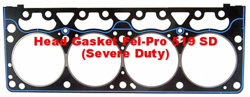

was mistaken. The blocked off coolant ports were on my Hughes F1 intake NOT on the head gaskets.
What head gasket did you use?
I used the Felpro 519 SD and didn't notice any blocked off ports.
