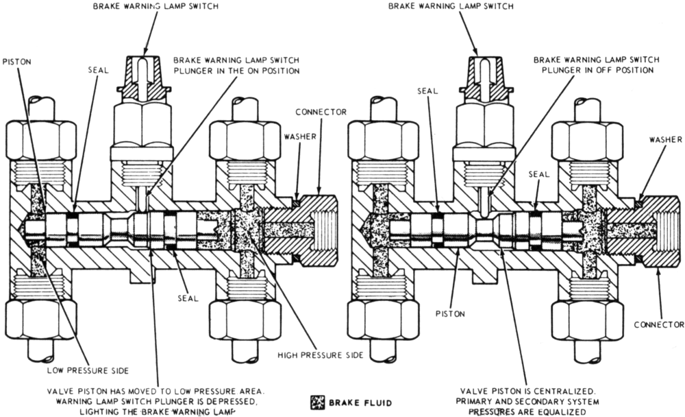

Sounds like it's working as intended then. The reason the ABS light is on is because the module is detecting a fault in the base brake system.
The switch looks for pressure differences between the two branches of your braking system. When it detects an issue, it activates. It's actually a very simple valve that sits between the two branches. The pressure difference pushes the valve one way or another, and if the difference is great enough, the valve makes contact and completes the circuit. It's a pressure switch basically.
Bleeding the brakes will help to re-center the switch.

Usually when people get there truck fixed we never hear what it was that fixed it, well here is mine. Thanks issakar, for the picture, it explained everything to me. I pushed the pressure relief at the end of the pressure differential switch, moved the plunger back and everything works good.
