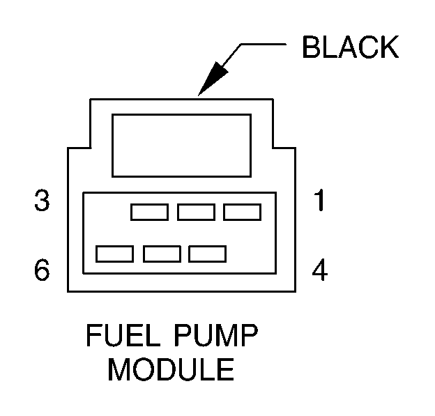

Originally Posted by onegoodmason
No fuel pump prime sound . Either something is shorting out tripping the ASD or the pump is bad . That's why the 02 wiring needs to be checked given the history . I'd just unplug them both and try a start . Not sure , but , you should be able to access the plug-in for the pump and test the power there .
Not exactly unheard of for the PCM to fail either but your not really getting typical symptoms IMO .
I definitely agree with the ASD relay tripping out, I just have a strong feeling its something related to that. Also, that was my plan for the fuel pump, I was going to pull the plug and hook a power source to it to see if it primes.
Can you confirm that I have this correct:
1) ASD relay output
2) Fused B+
3) Fuel Level Sensor Signal
4) Ground
5) Sensor Ground
6) Ground

Originally Posted by XJ_Robbie
Can I find the wiring diagram(s) somewhere online, or should I purchase a Haynes/Chilton manual for the truck? I have a haynes manual for my Jeeps and it has wiring diagrams, but Im not sure if they have anything detailed enough.
Best I can find for ya is 2001 . Shouldn't be a lot of change , I hope .
01 Ram
http://www.mediafire.com/view/azahhd...rts_Manual.pdf
http://www.mediafire.com/view/oeeqjy...ice_Manual.pdf
I'd still try a coil if you can borrow one and inspect that 02 wiring for damages . Or , try yours on a buddies jeep 96-99xj 96-98zj
