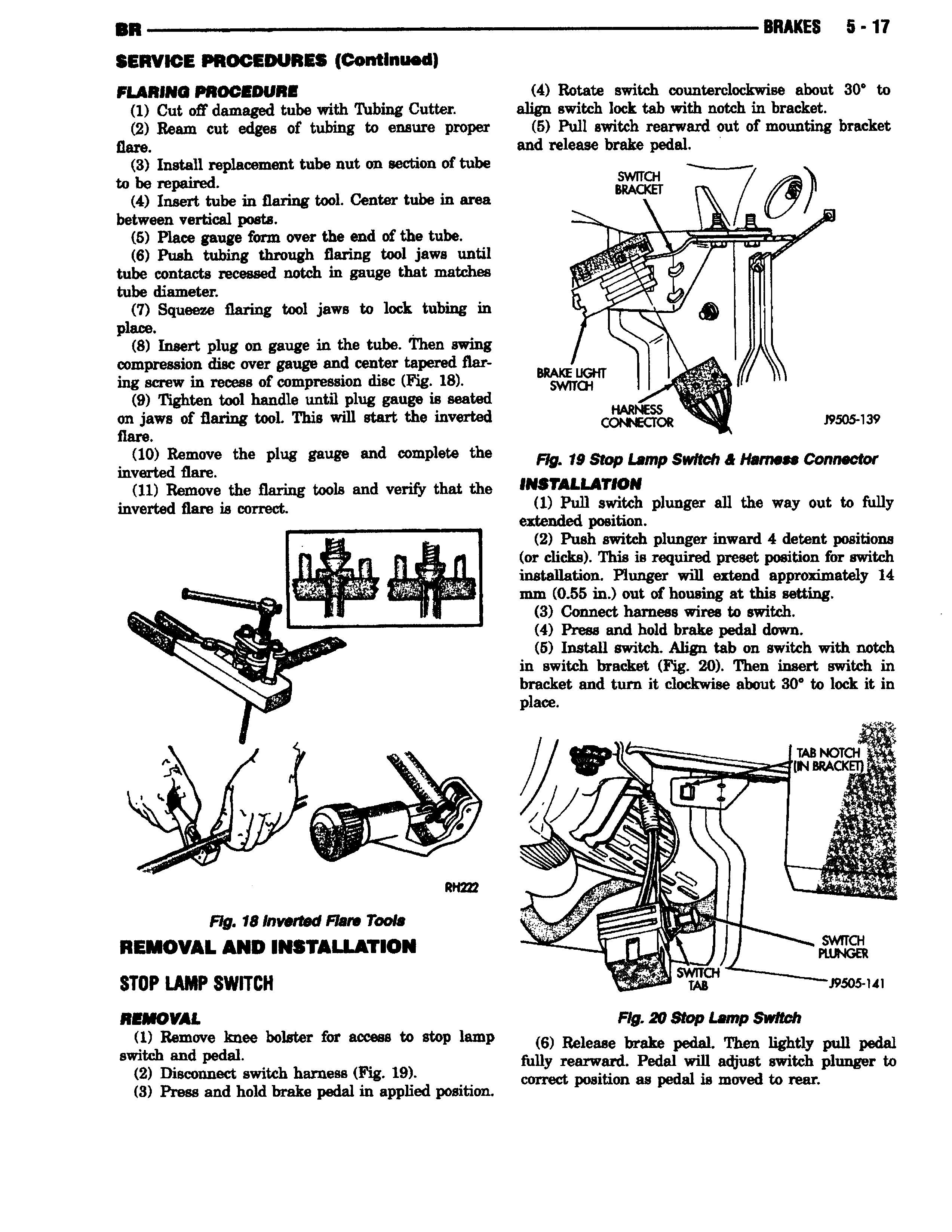

^. Did they? Also there is an "adjustment" procedure for the new switch. Check out the 2001 FSM.

There is a slight bit of adjustment you can do when you put the switch on. Make sure the switch is away from the arm before you tighten it down. Also may want to lube the arm itself if it's sticky the pedal wont want to return fully and the light will stay on.

Here you go...
Attached Thumbnails Brake Lights Won't Go Out-brake-info001.jpg   Brake Lights Won't Go Out-brake-info002.jpg
