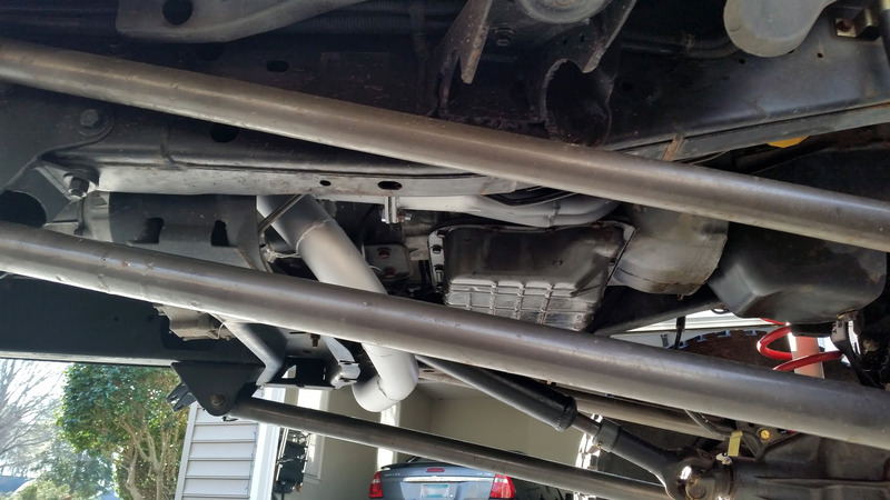

Once I finally got the old exhaust completely removed, the Pacesetters fit great, except that the drivers side collector exits 8" in front of the transmission cross member. So I welded up several sections of 2.5" mandrel bends from Summit to snake down and around the front driveshaft and over to the passengers side. Gave the cross pipe several coats of VHT header paint to test how well it doesn't work.

A new Flowmaster catalytic converter just arrived from Summit so that will be hooked up the the back of the crosspipe, but for now the truck is back on the road. Sounds great, definitely picked up some low-end torque from the headers.
I have one of those universal Thrush glasspack mufflers in the center, and then an old Flowmaster 30 series muffler at the rear (located where the spare tire used to be)

I always wanted to see how the long tubes fit underneath our trucks. Nice work on the cross pipe, looks good! How bout a pic of your truck too.

Nice add of the flanges... and the Y-pipe crossing in front of the cross-member is good if you need room for a CAT on SWB models.
My pacesetter Y-pipe runs behind the cross-member.
