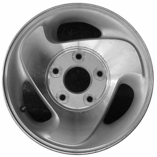

the rims are the OEM 3 SPOKE Silver with Machined face Wheel used on 1998-2001 RAM 1500's the important Specs include....
16 x 7 rim
5-139.7 (5 x 5.5)BP
+19.05mm offset
The door tag indicates the truck should be equipped with 225/75/16 or [alternate but uncommon OEM] 225/70/17
