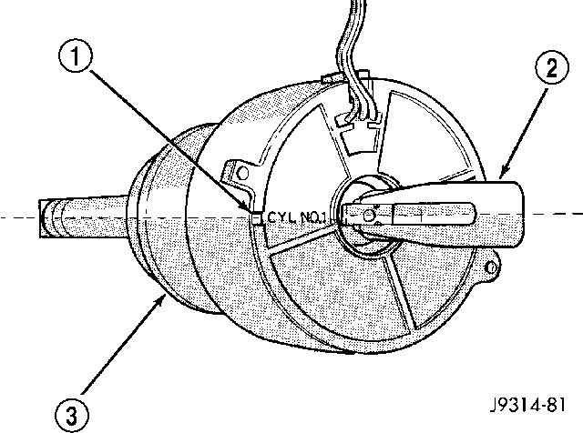

You most likely need the fuel sync set.The computer handles the timing. The fuel sync is set with the distributor. There is a notch in the housing to align the rotor for a rough setting. Then adjust while hooked to a scanner.

And here's a pic...
