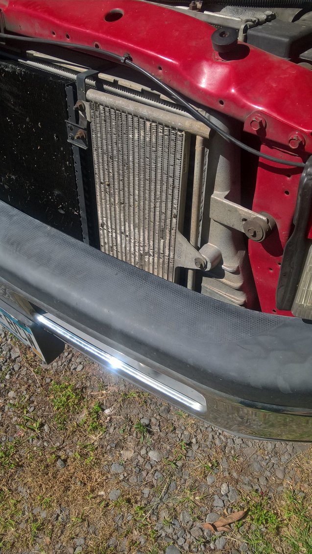

from what I google about O/E P/S cooler on your truck, it shows the cooler being about 27" x 7". if it came with one that big, I would imagine they put it on there for a reason. a sure way to find out would be to call a dealer with your VIN and see what one you need ( get part # from him) and then cross reference that number for a cheaper one somewhere. looks like there are plenty of aftermarket options out there, but if its as simple as bolting it right up where its supposed to go, that would be easier.

Racefan, look at post #13. Looks to be about the size you mentioned (hot weather cooler?). Mine sure is not that big though. Mine is about 4x9 inches or so.
