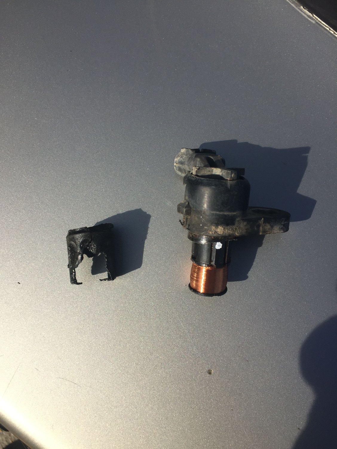

Sure. Until the sensor came out like this:
Rear ABS Speed Sensor, minus its housing.
My efforts to remove the sensor gently resulted in the coil housing breaking off in sensor hole. Lovely. Since the housing had snapped off just above the rubber sealing gasket and flush with the differential housing, I wrestled with the plastic piece for another twenty minutes or so. Here's what came out:
Hmmm...there's a lot of plastic missing from the bottom here. Crap. I didn't want to have to dive into the differential housing, but it looks like I don't have a choice now.
