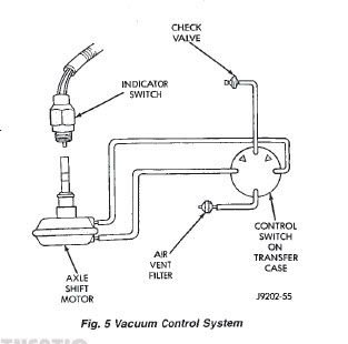

1996 ram 1500 4x4. Okay so I have no idea where my red and black vacuum lines go to. Also do the metal lines that run from the cad unit to the transmission crossmember and bolt up right there run to anything? Thanks for the help

You have a white line coming from the manifold vacuum lines that go down to the switch on the transfer case. A green breather hose that come down from behind the motor to the switch on the transfer case. Then the Red & Black lines got from the switch on the transfer case to the metal lines which run across the tranny crossmember up the frame by the passenger wheel then turn back into the Red & Black lines then plug into the CAD

Make sure you good vac going it to the switch then check that you have it coming out (both in 4WD and 2WD) at the cad.
