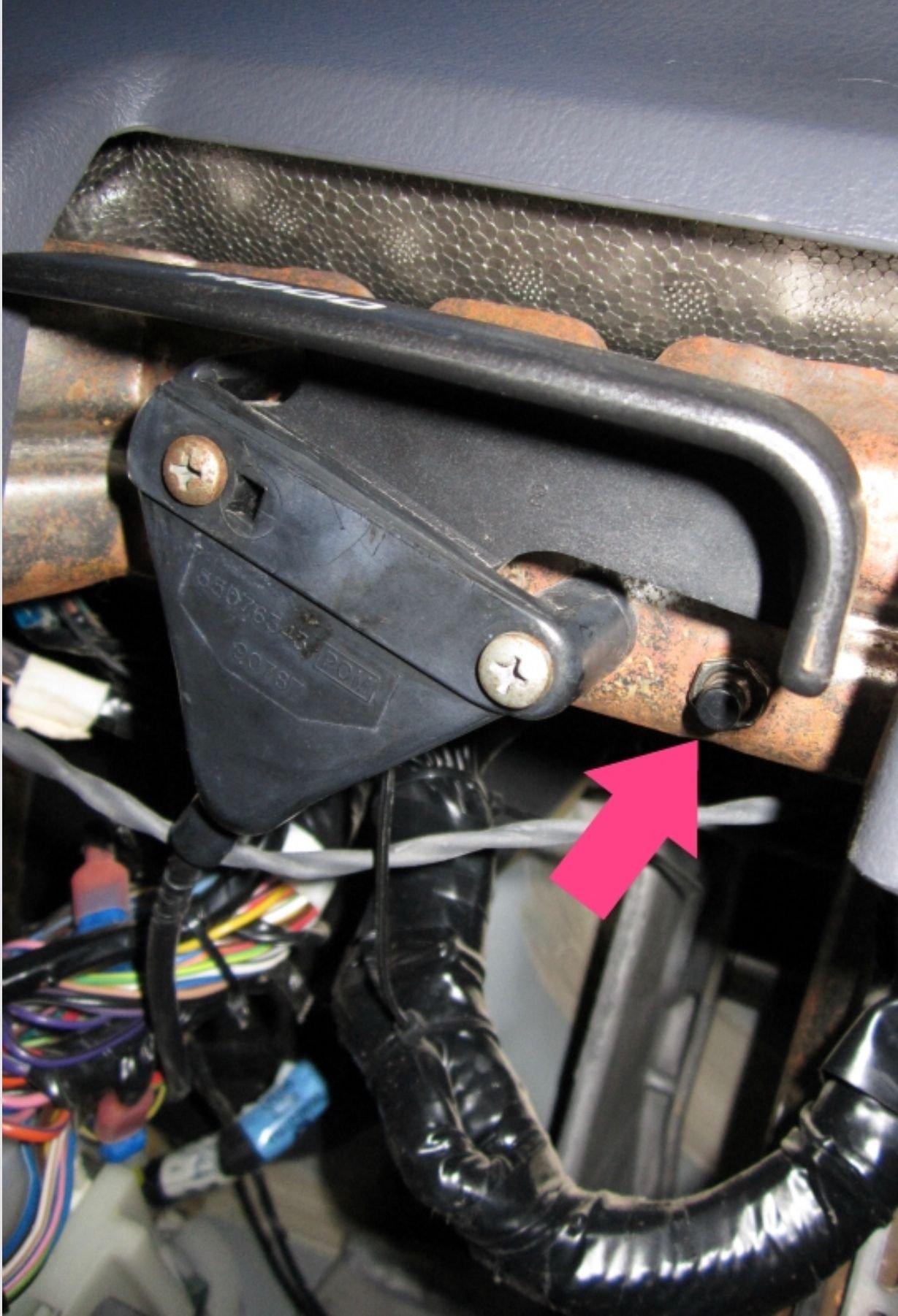

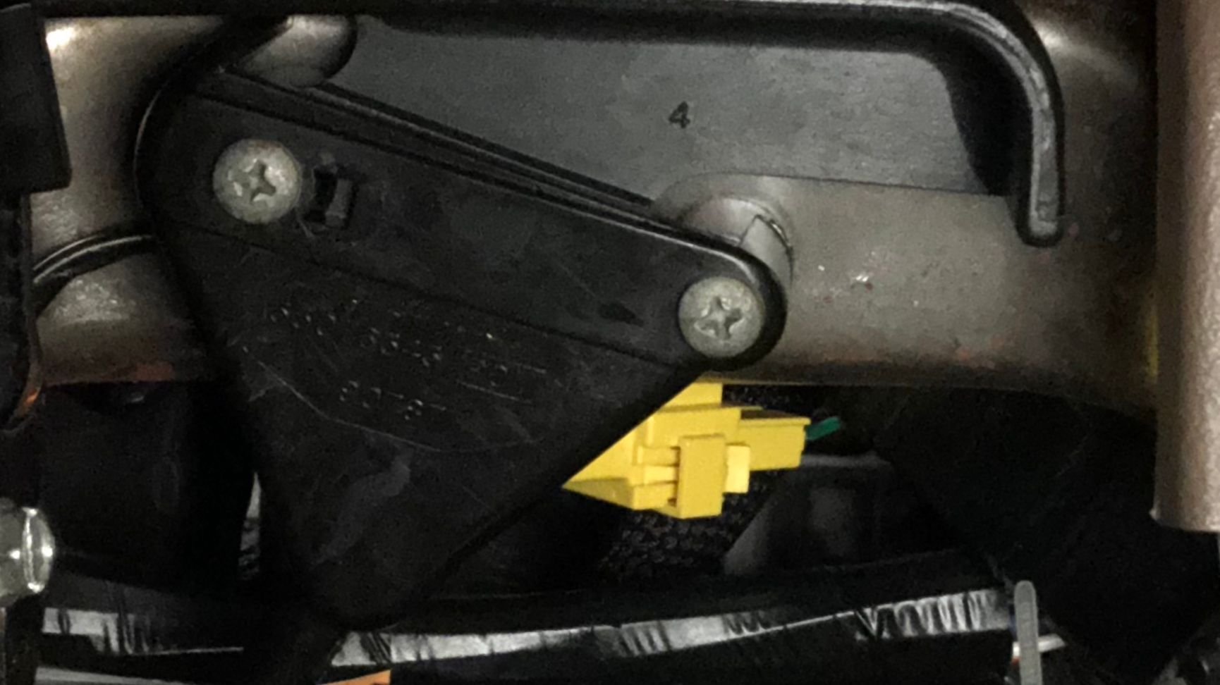

When I get home, I will see if my ‘01 has that valet button, now that I know where it should be.
Now, being that I have no fob whatsoever, will the valet button even work to turn off the alarm? I couldn’t find a speaker inside the cab where the alarm sound comes from. It’s definitely in the cab and not under the hood.
