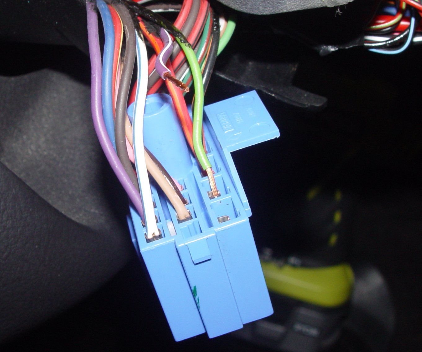

This might not help, but my truck headlights went out one night on the way home, and I noticed when I tilted the steering column up and down the lights would become intermittent. Took the plastic housing off the steering column and found one of the wires on the back of the multifunction switch was completely disconnected and another was almost disconnected. Since the wiring harness was borderline too short, I patched a short piece of wire into the harness and soldered both loose wires back into the plug. That fixed the problem and it never happened again. YMMV
Chuck
Before repair
After repair
