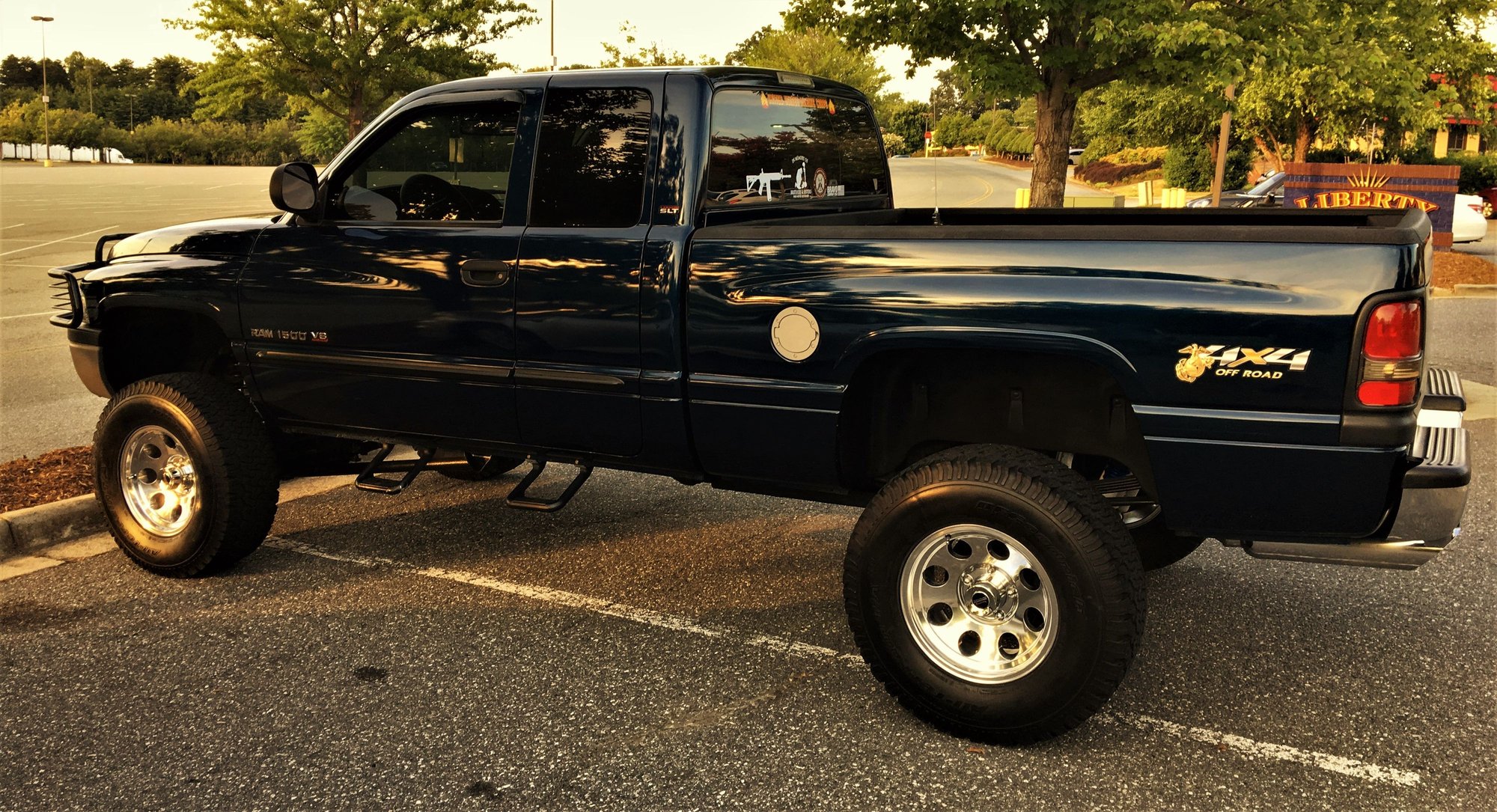

An up date on Big Blue....New Paint...new rims & tires...New paint under carriage.....new stereo...Pioneer...Sony 800watt amp & Infinity subwoofer & door speakers.....2018 project....SF
