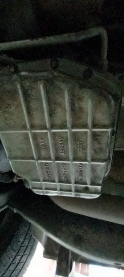

04 ram 2500 5.9 Cummings 2 wheel drive auto.
I changed governor pressure solenoid and transducer and filter but not speed sensor. I replaced because truck was jumping into and out of gear, it never set a code. I figured I would adjust rear band and hand torqued with 1/4 in drive and backed off 3 turns as per most instructions. Now jumping gears is fine but truck does not start in 1st gear unless I manually go from park or neutral to 1st. It seems to start in 2nd gear and now it has p0868 line pressure code.

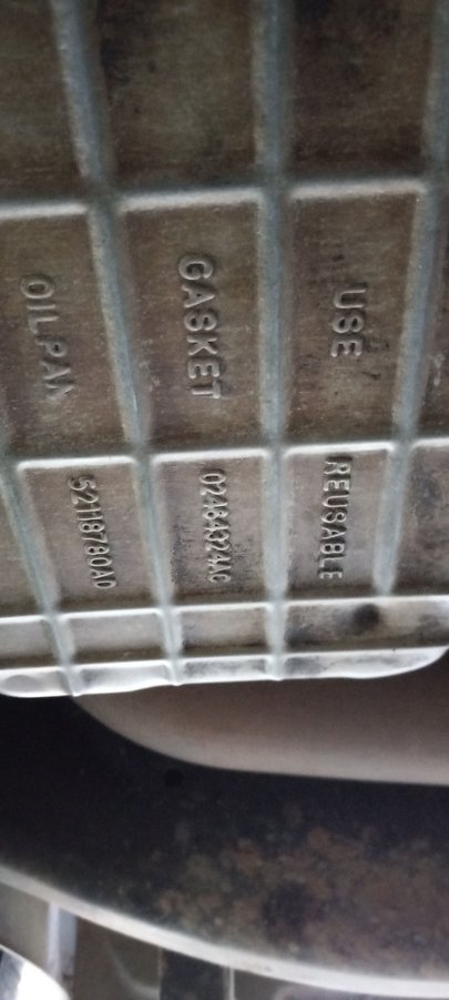

Can loose rear bands or the speed sensor cause line pressure issue? and based on pic attached do I have a 46re?

They didn’t put 46re behind a diesel….you have a 47/ 48re….and that sounds like the TV cable needs adjustment not bands. And the bands I’m pretty sure are supposed to be 2.5 turns not 3
thanks for reply I will verify transmission from tag today
