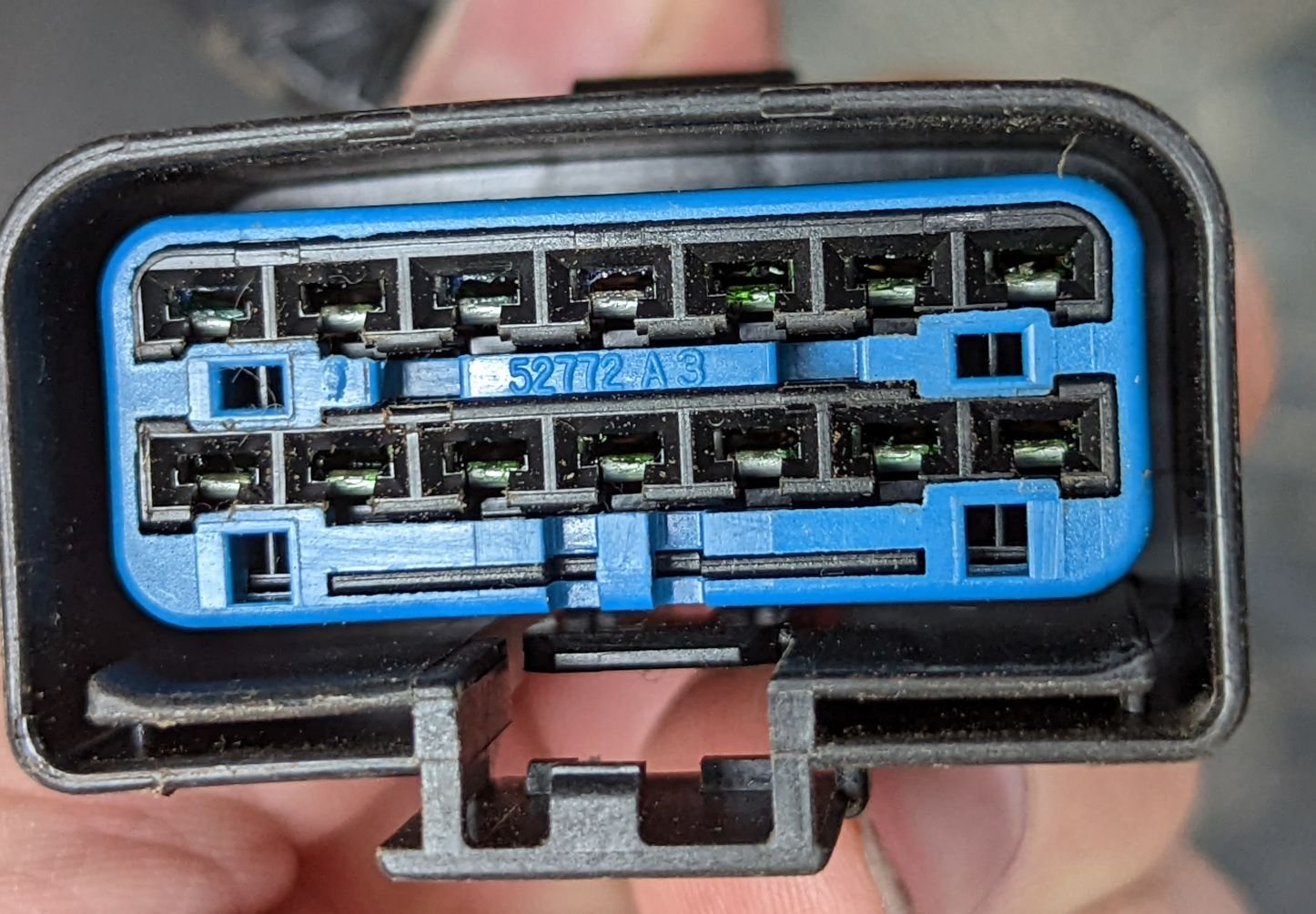

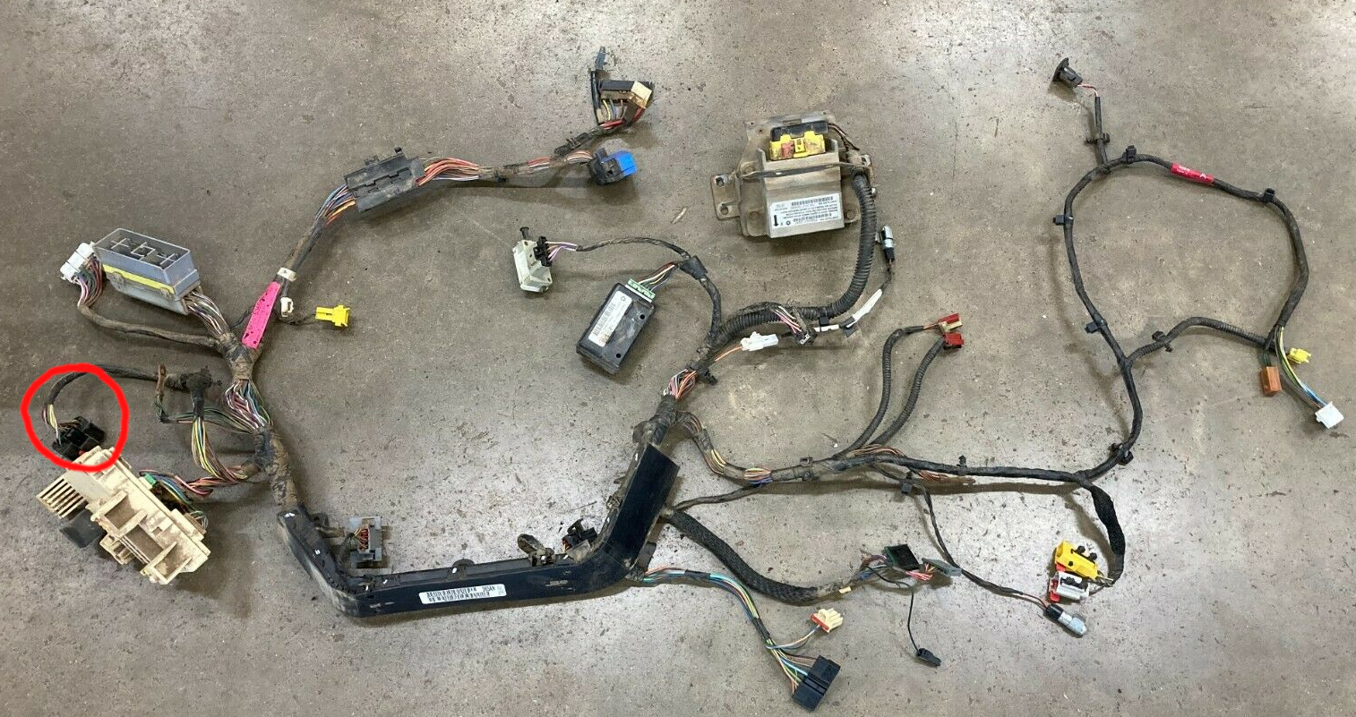

Hello all, working on a bunch of stuff on my 1999 1500. Just did the dash replacement but I find myself with 1 extra connector and no clue where it goes lol. Hopefully someone can help identify so I can move forward, appreciate any help.
Here is an image, I have circled in red the plug in question. I pulled this image from an ebay auction and I am 100% it is the correct plug.
Any clues where this plug would go?
Got some close up pics as well, I am currently looking through wiring diagrams trying to match up wire colors.
Front
Back
Pins

So I found this website - http://connectors.dcctools.com/results.htm
Searched for 14 pin and got a clue about blower resister... this jarred my brain to consider perhaps it goes to something I have not put back in the truck yet. Lo and behold it is the headlight/dimmer/cargo control block...
I literally told myself, "I should just keep assembling, trust and Ill find it. But I panicked and second guessed myself.
Anyways, thanks to all who took a look to try and help.

That is the headlight plug...
