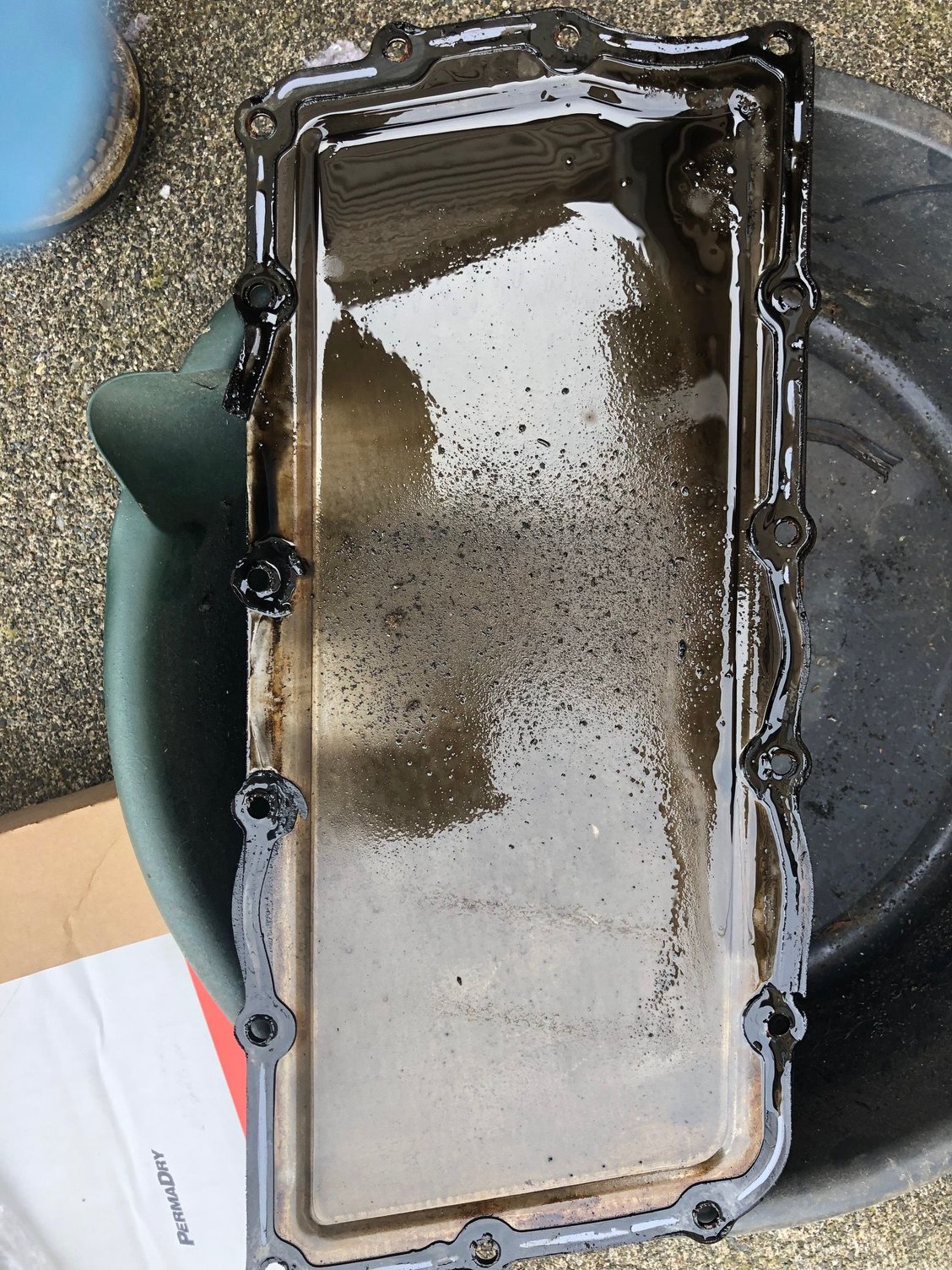

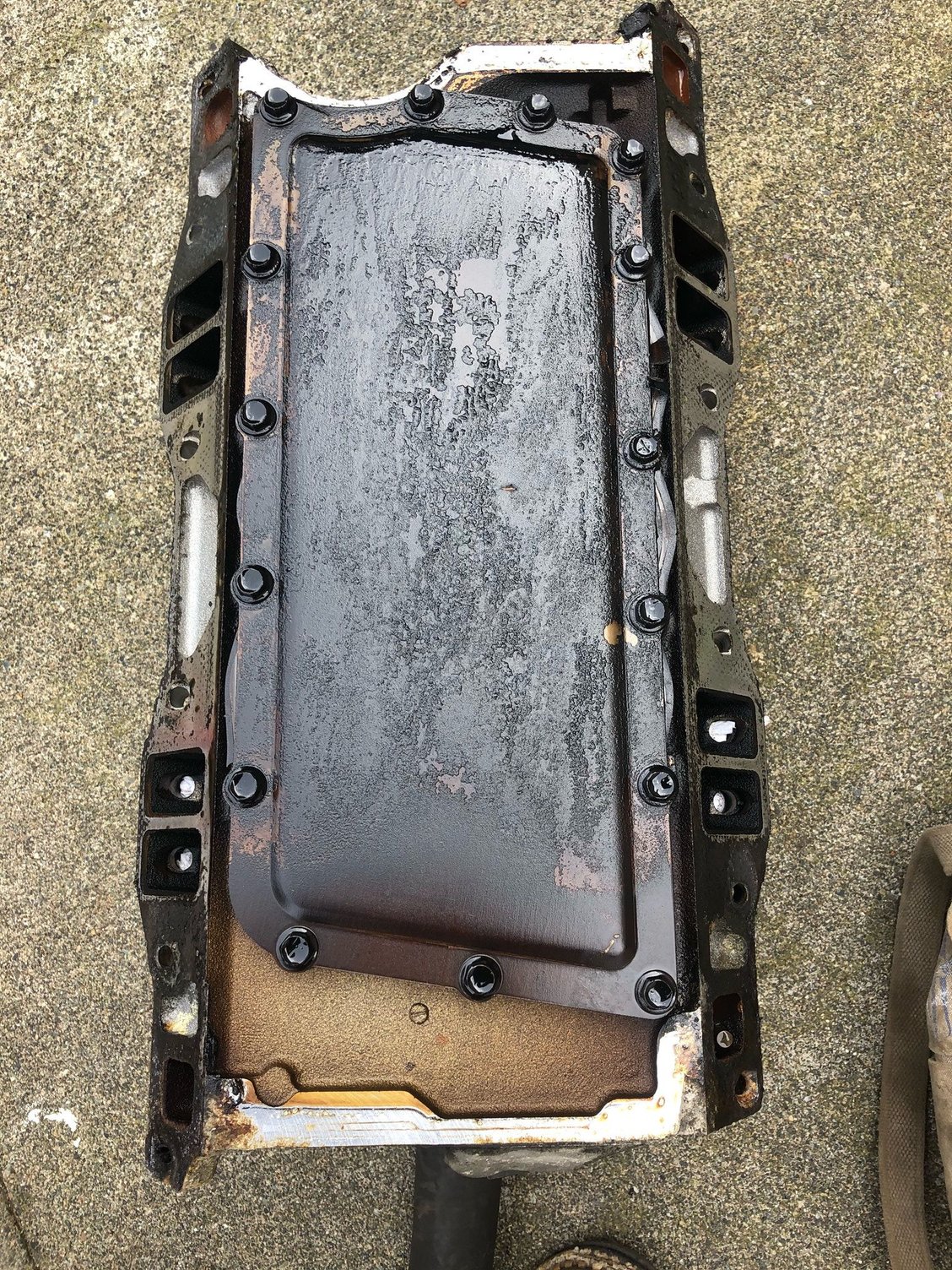

Got the hughes kit in today. Here is my intake/plenum.
also, the intake bolts were all finger tight and the front passenger side snapped

Just wanted to give everyone an update if anyone else is suffering from extreme oil loss and think their plenum is the culprit - the hughes kit did in fact fix the quart of oil loss every 50 miles. So far, have 200 miles without a a drop on the dipstick!
