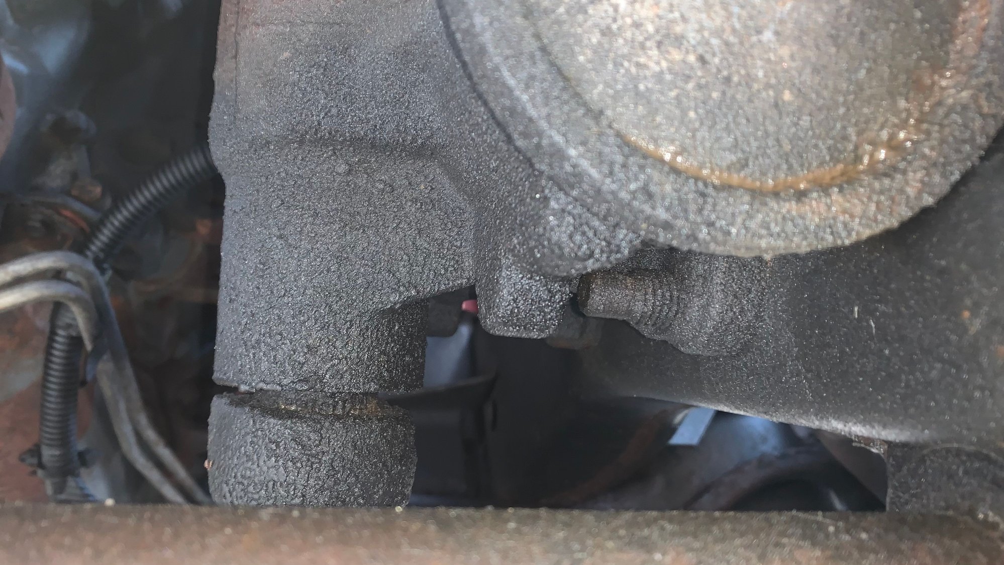

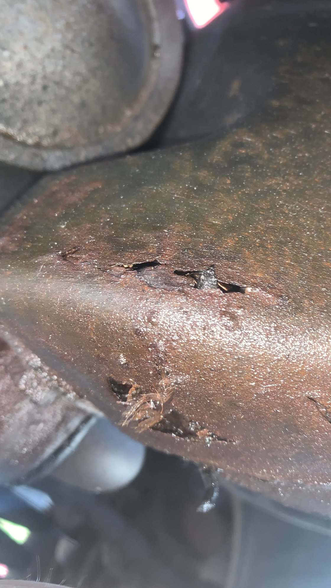

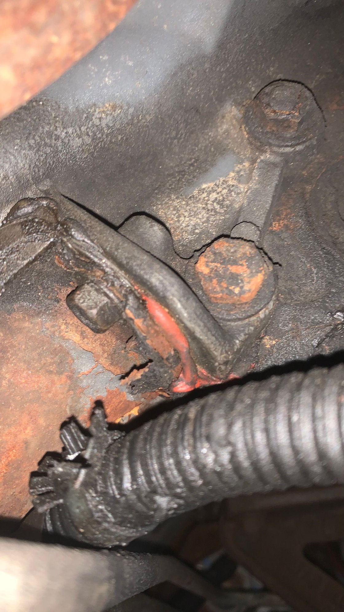

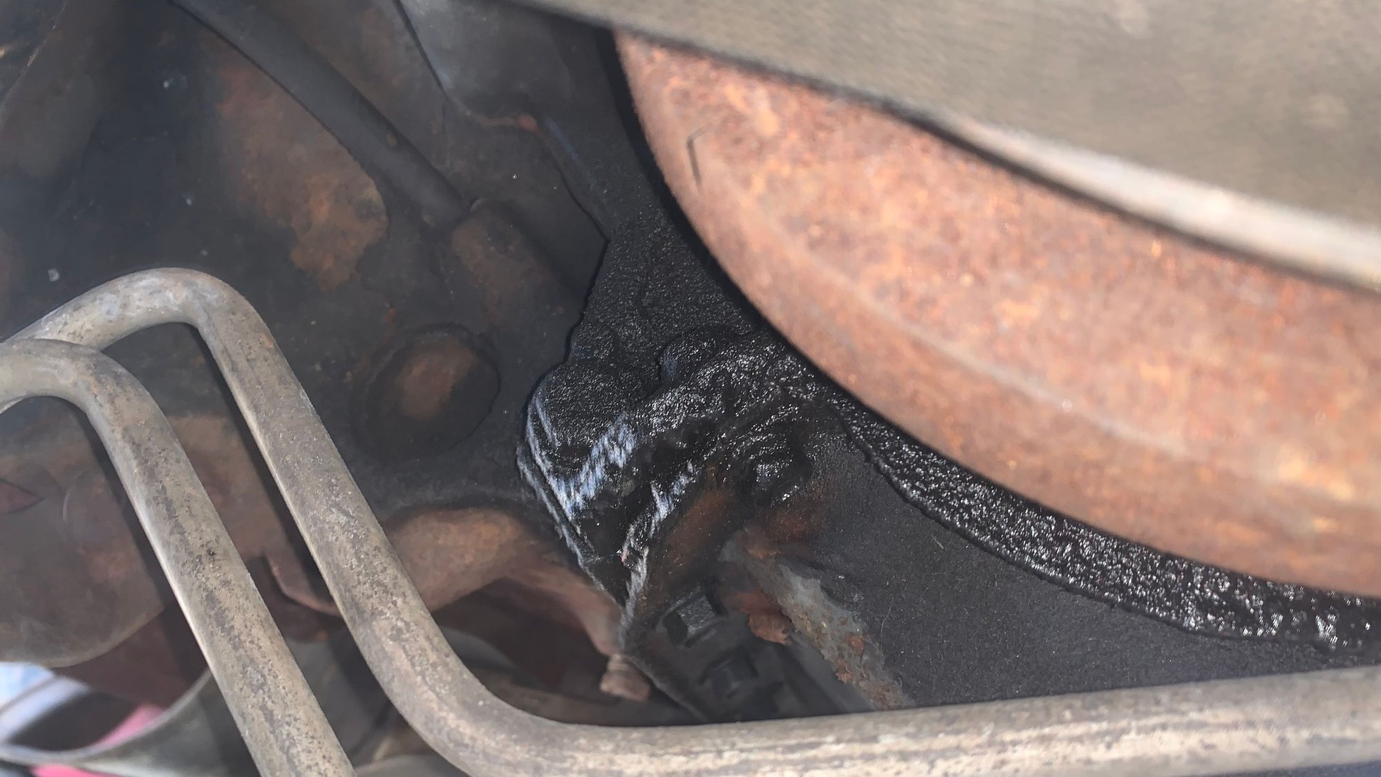

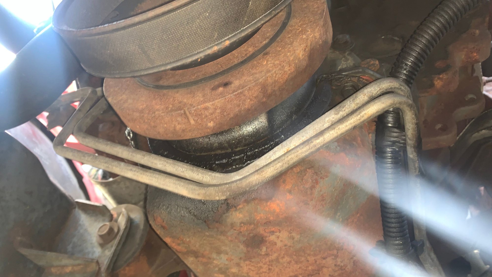

Found some things.

Are those photos from before the motor was cleaned or after? As mentioned before, the motor really needs to be cleaned up 1st and/or use dye to truly find the source of the leaks.
Haven’t gotten around to it yet. The pictures are just for a better example of how it looks under there. More so up front. I’m currently gathering everything I need to clean it all up and get to searching for leaks. Just been working a lot recently.
