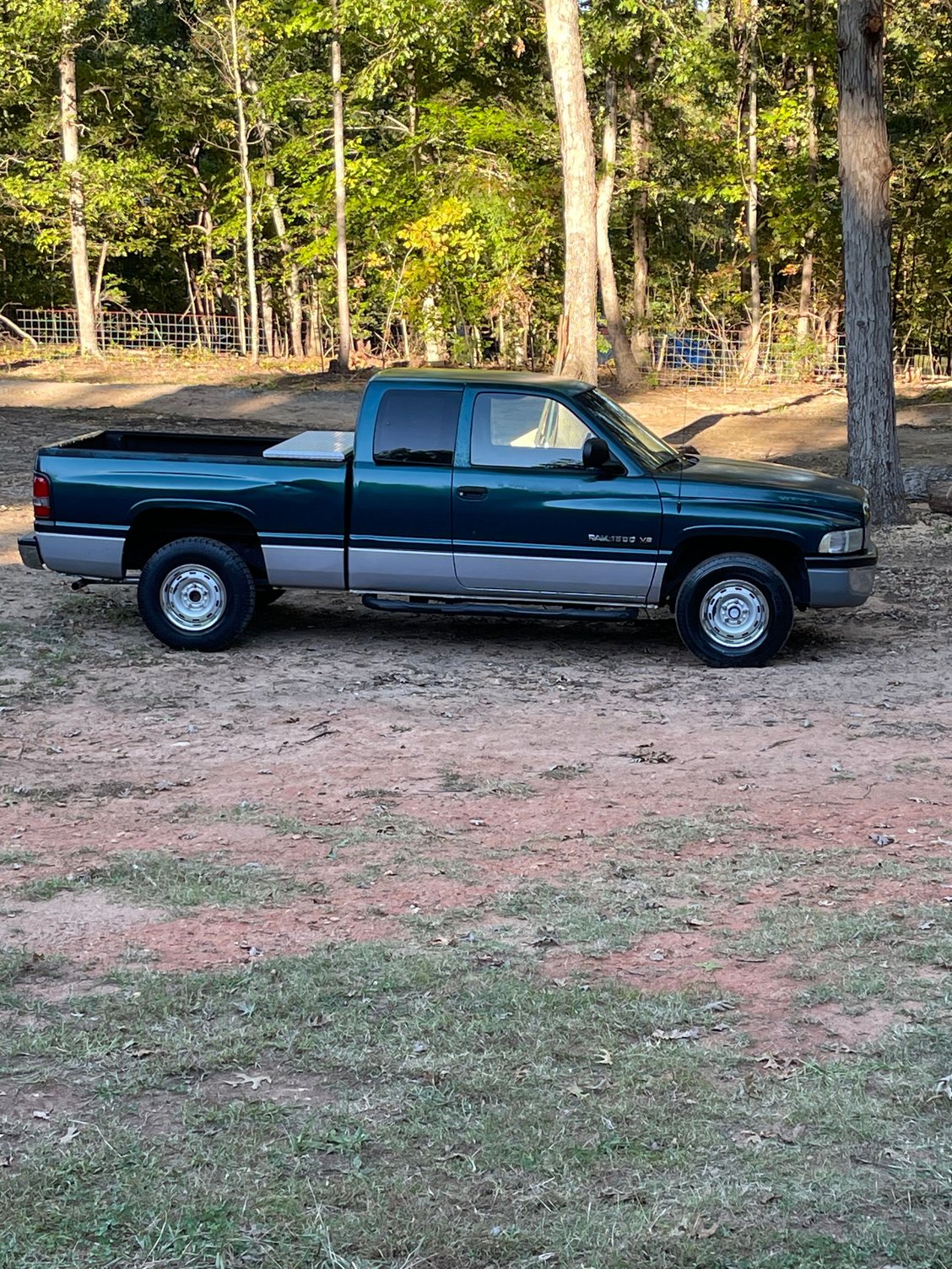

I’ve posted before, I have a 99 1500 2wd 5spd it’s my work/farm truck that only gets used occasionally but it sounds like hammered hell. The exhaust on it is a better representation of Swiss cheese than anything else. What are the best bolt on options out there. Local shops typically get $350-500 for a full “custom” system not looking to shell out that kinda dough I want something that will have a good sound but be mild. I also have to mention my cats were removed by the previous owner due to them being clogged any insight is appreciated
