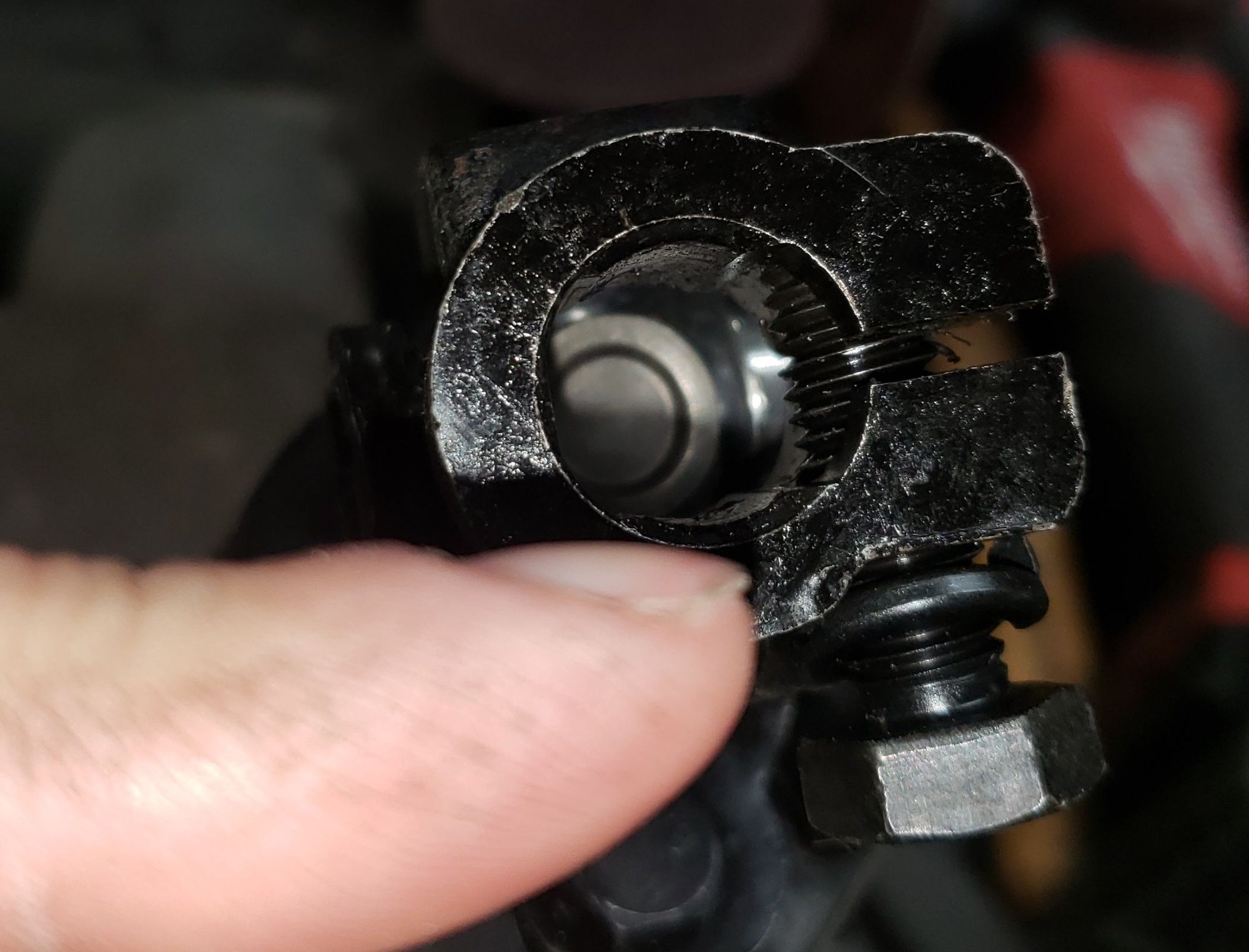

The bottom line -- not surprisingly -- is that the part is junk. More specifically, the part physically won't fit because of poor manufacturing tolerances.
The position of the pinch bolt at the firewall end is too close to the shaft such that the bolt cannot be fully inserted. It fit fine at the steering box splines but would not work at the firewall side.
YES, I realize there is a radiused groove in the steering column shaft which engages the bolt, ensuring that even if the pinch bolt is loose the shaft cannot separate unless the bolt is completely removed. I had this groove aligned perfectly but the pinch bolt will not drop in. At one point I was able to (cross)thread it in, but once it encountered the ACTUAL threads on the opposite side of the pinch sleeve it could NOT engage them because it was slightly cocked and/or under so much load.
If this bolt hole had simply been moved ~.010" to the OUTSIDE DIAMETER of the pinch sleeve I bet it would have made it.
Here, finger points in the direction the pinch bolt needs to be moved over. I truly think ~.010" would have done it:
