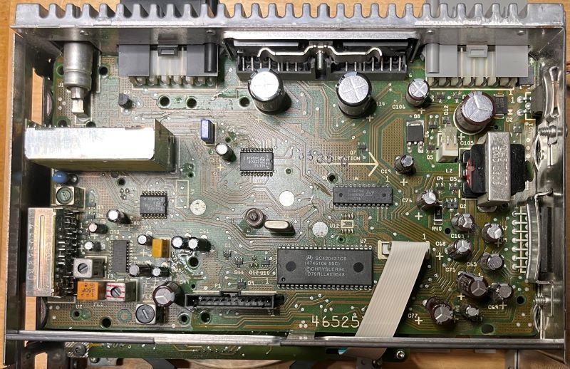

Here are the topside board shots of the original with CD board and the 'new' no CD board. There are lots of differences, unfortunately; it wasn't just some unpopulated chips and such for a board lacking CD features. But, it also looks similar enough on the left to bottom left, where the whole tuner sections are (as best i understand). Now i just need to figure out useful tests to run.
Original board
No CD board

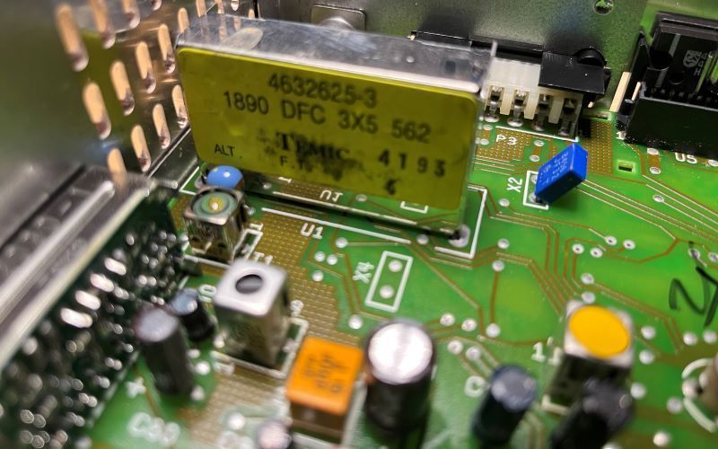

Tuner cans of the two boards seem to be identical. Not sure if just straight out swapping them would be enough to fix the issue, as i don't know how much it relies on the adjustable thingies near it to be tweaked just right... Plus i still don't know if its broken.
No CD tuner(?)
Original tuner(?)

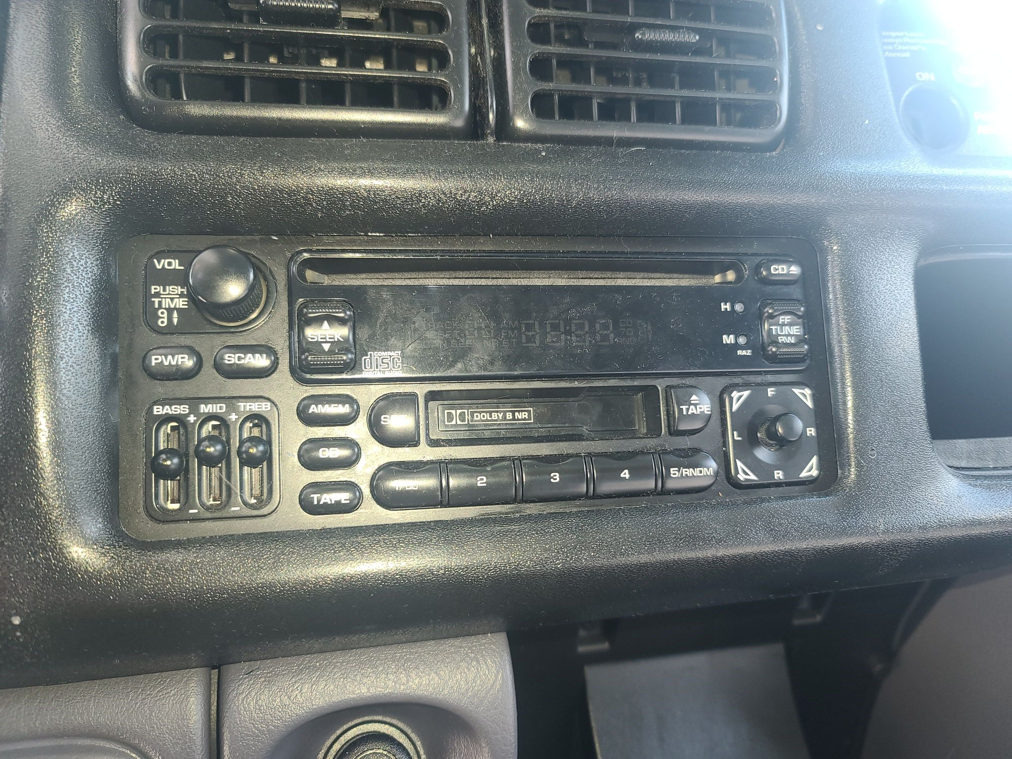

Here is the picture of my radio in the truck. Mine has the cassette and CD. There are some with car-part.com

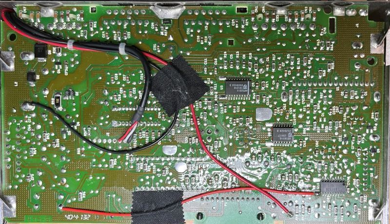

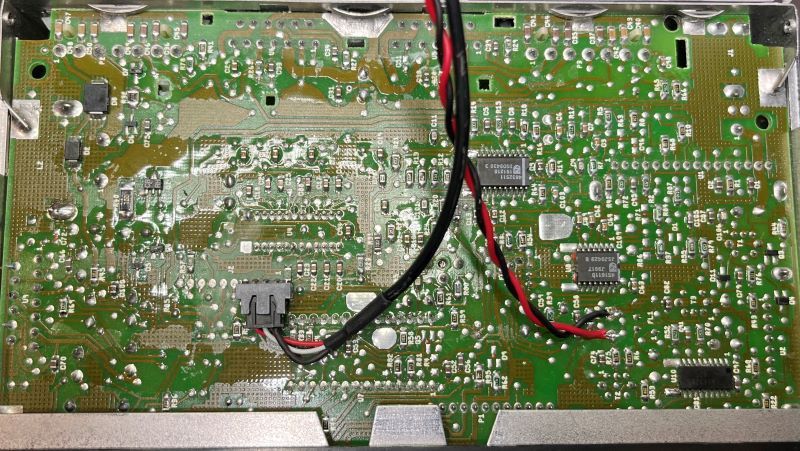

Bunch of progress, and mostly a success. There is still a noise from the bluetooth signal at higher volumes that i'm not sure how to kill. Basically as long as the module is powered the input cable is enough of an antenna that it picks something up even when the cable isn't plugged into the module. And powering the module separately didn't seem to help either... I haven't tested it on a drive yet, with the background 'hum' of the Cummins, so not sure if i really need to dig deeper.

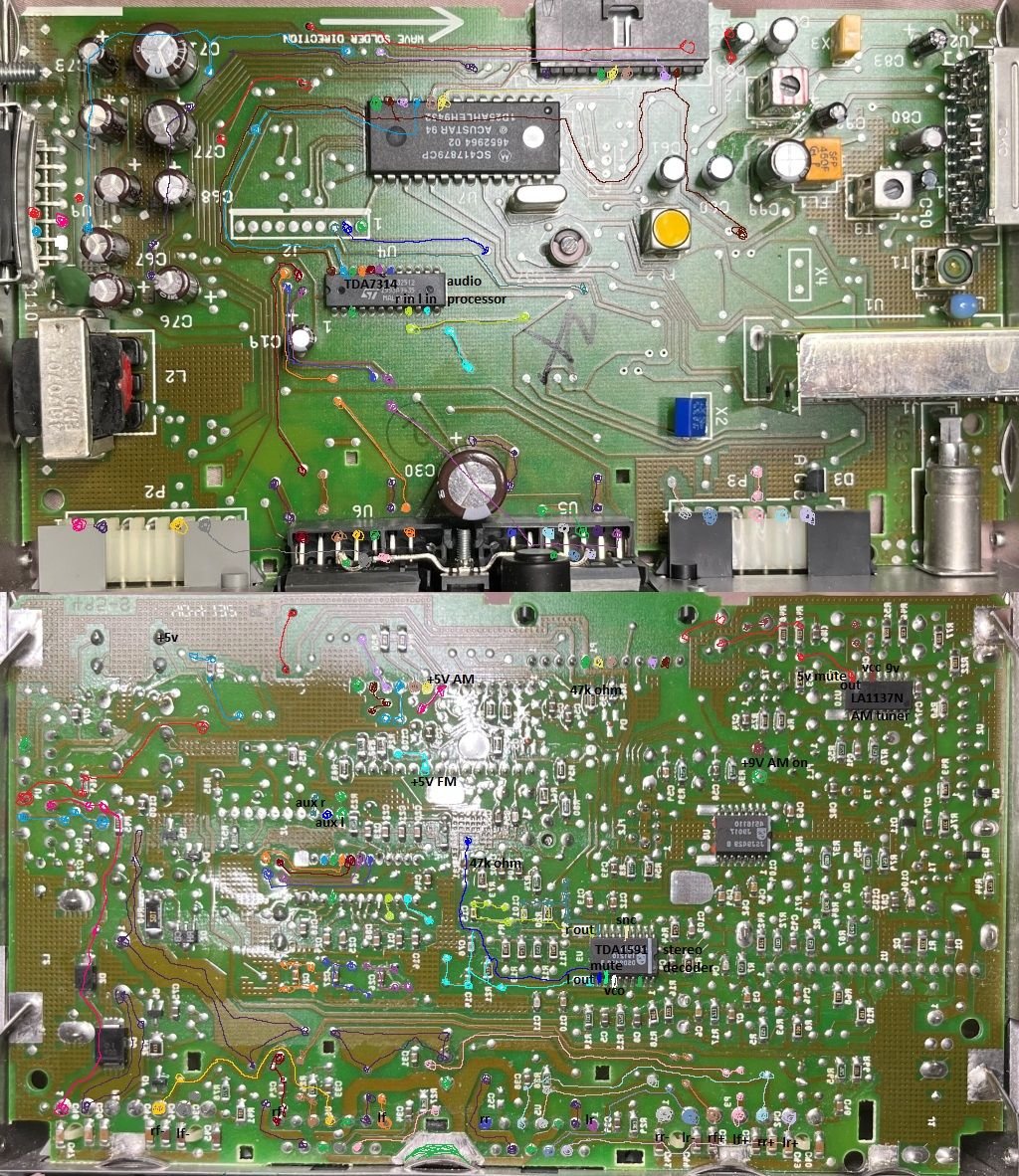

First i traced out a bunch of the board to try and narrow down where 'sound' was coming from and going to until i hit some chips. Starting from the outputs and the output amps it was simple enough to hit the first real IC, which all have custom names annoyingly. But enough googling makes it appear to be a TDA7314, an audio processor for balance/fade and EQ stuff, and the pins matched datasheet to my board. That got me more pins to trace for stereo inputs. Those pins went off to an IC i think is a TDA1591, a stereo decoder that does AM mono to stereo also. Which is one of those things i didn't even think about, AM is sometimes mono... So my latest plan of stuffing stereo in on the AM lines sort of fell apart there. But i had already traced some of the AM tuner (LA1137N) side out too, just slighly confused on the single 'out' line which made more sense now. Used paint as my awesome drawing tool. One of the faces of the board is mirrored to make lining up the two sides easier.
With this knowledge in hand i wired up the module output directly to the output of the stereo decoder thing, and put 5V on the mute pin of the AM tuner to make it shut up always. I stole power from the AM tuner ~9V supply, which only is on while the AM range is selected. And it was horrible. All the volume from the phone and the radio and it would make some recognizable noise, but barely and badly. Sucks to only be able to test in the car, but out it came again.

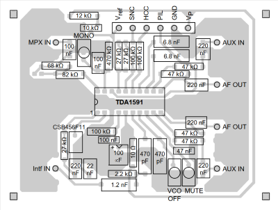

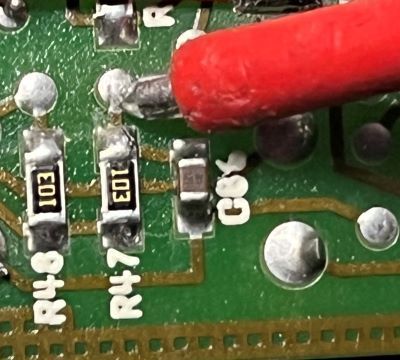

I read the datasheet on the stereo decoder again and saw a test circuit where they had Aux inputs. Read some more and they mentioned using the chip auxiliary inputs for cassette etc. I looked more closely at the board and sure enough it was almost wired for aux inputs already. There were 2 47k ohm (based on the datasheet) resistor spots not populated on a path to that blank silk screened box on the top side (probably for a ribbon cable to a CD/cassette in another model). I got some resistors, plopped them in, rewired the module to the ribbon cable spots and it was much better, but very quiet and there is still some noise. I didn't want the volume to be drastically different from bluetooth to FM so flipping through would be annoying/scary so i figured whats the worst that could happen if i changed the resistor values. Half was better, half of that much better but the phone volume still has to be maxed, and half of that (4.7k) lets me set the phone volume down some and fine tune to match the FM. But for some reason the mute no longer seems to work?
Just remove this, no more AM sounds. Then i can remove the 5V off the mute too. Still bluetooth noise at higher volumes, only really noticeable between tracks obviously, but kinda annoying.
More poking around, testing various things, i end up changing the ground point for the power which helps a ton. Also changed the source point a little just to be closer to the ground (they share a cap now i think). Removed the direct solder audio source for a socket that came with the module just for neatness. Moved the module itself outside the radio in the hopes of less noise (didn't really help) but no longer plan to put it back inside anyway. There is still bluetooth noise on the AM side, more when its using data, noticeable when playing music at 0 phone volume or between tracks. Need to test in drive and see if its good enough or do i need to learn more about RF noise on analog audio sources. Or maybe i need to add those 220nF caps inline on the audio source like the datasheet said (though the board wasn't wired up for them, assumed they weren't that important).
Here is the datasheet test board. The two 220nf caps right at the aux in might help? Might just put them in anyway since i doubt it can be worse. But then again my resistor values are 1/10th of what they have to sound right.
