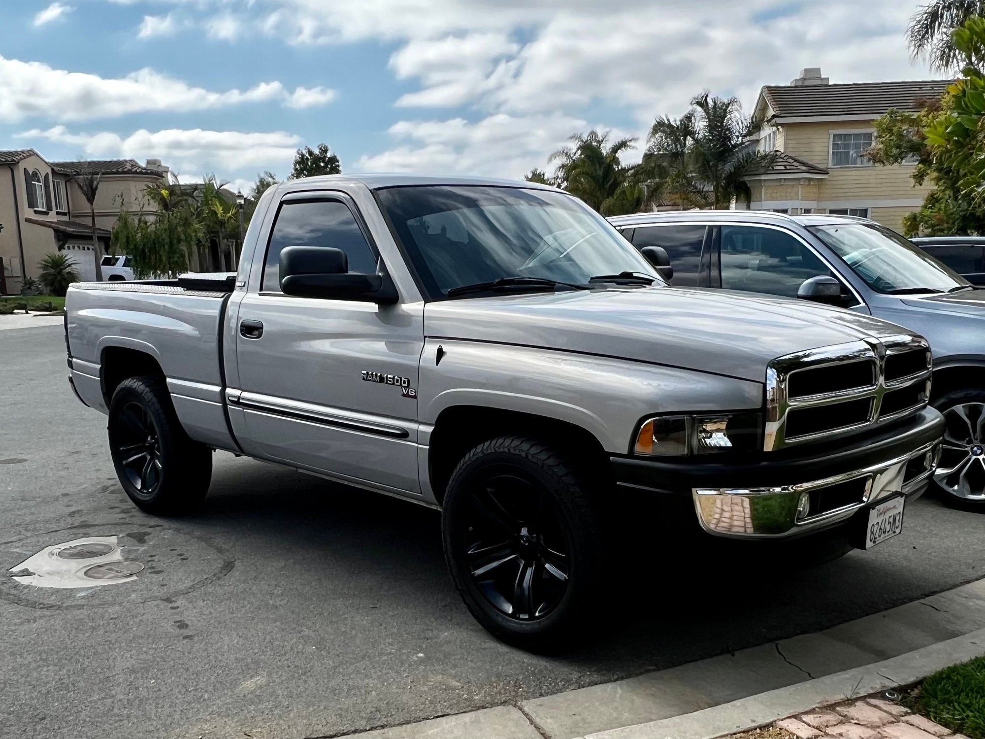

Found a CLEAN 2001 Ram 1500 regular cab short bed Laramie SLT at a great price. Had to have it, and now I’m the lucky owner. 127,000 miles, but she seems to have been babied her whole life. 5.9 Magnum sounds absolutely beastly. Cosmetically it’s pretty straight. I’m not a big fan of the mods done by the previous owner. I’ve got my own vision I’d like to stick to.
I drove it 3 hours home with no issues. I did notice however that the truck seems to struggle at highway speeds, especially uphill climbs. Not even steep ones. It seems like i need to really floor it for the OD to kick in and even then, I’ve gotta keep my foot down for it to want to stay. I’m guessing this could be as simple as a TV cable adjustment? Also, I’m experiencing this odd “shushing” noise from inside the cab. I don’t know how else to explain it. Take a listen here:

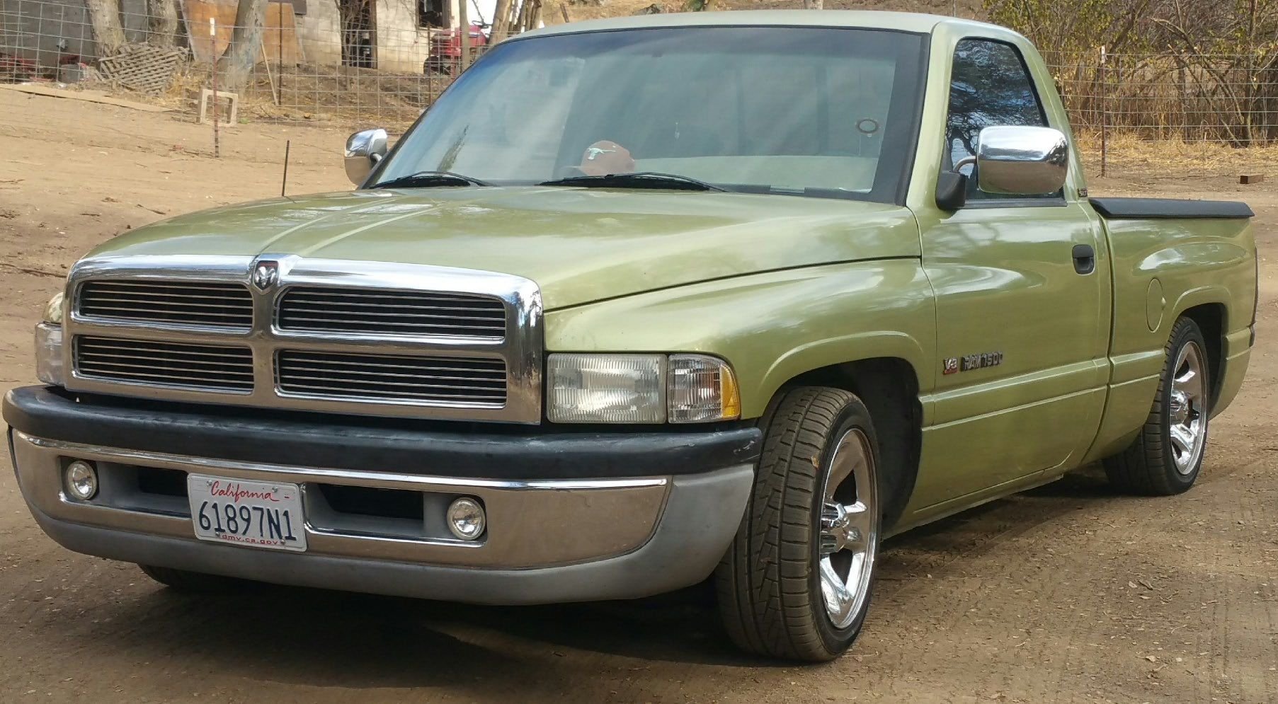

Here’s the vision I have for the truck someday
of course, still keep the stock silver color! But the stance is awesome, as well as the mild custom touches. These are sharp from the factory and don’t need much to look amazing imo.

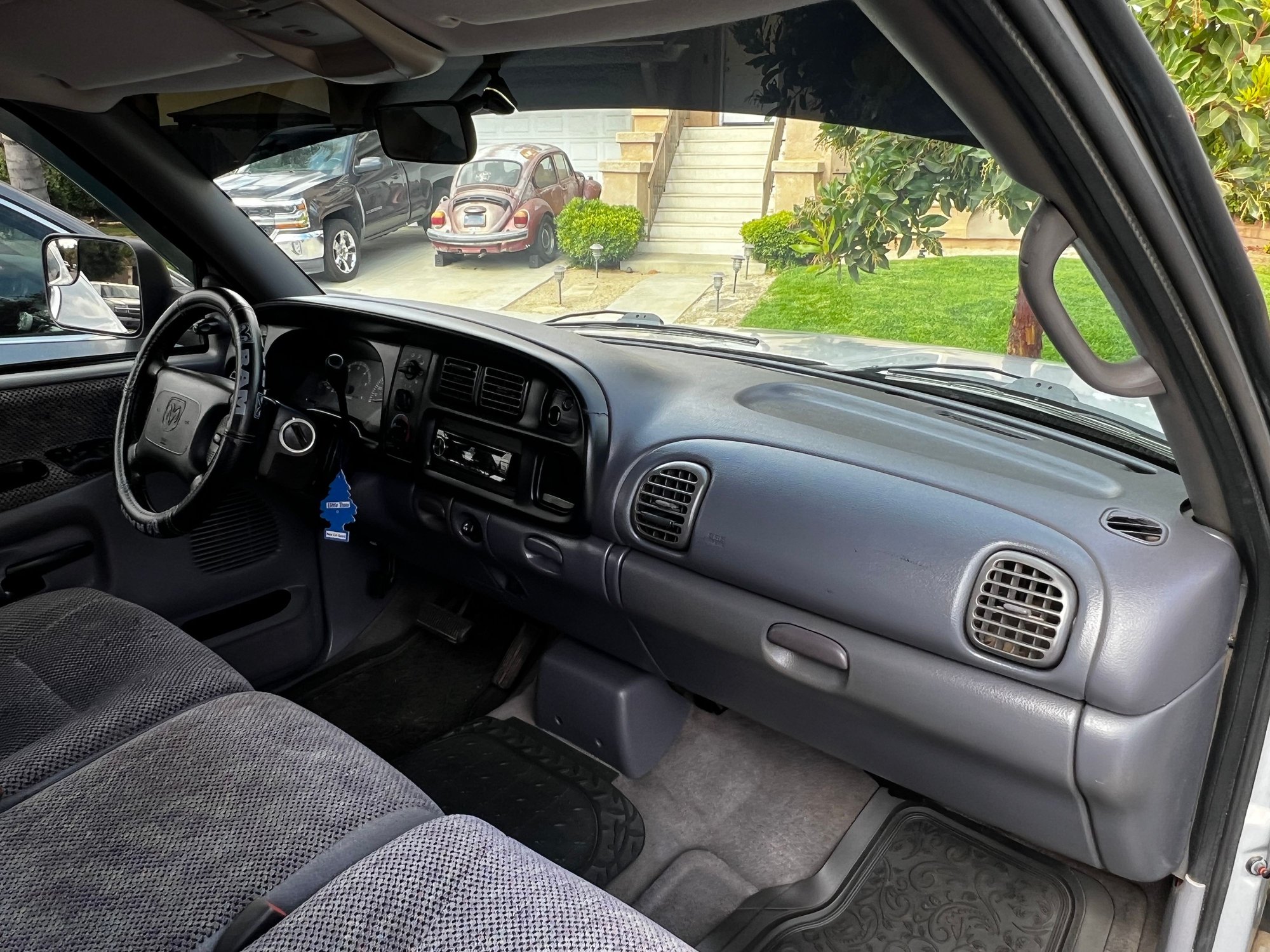

If it isn't broke, don't fix it. Otherwise, as Red Greene says, "It it's not broke, you're not tryin'". Seriously, I didn't hear any problems. I did hear some road and wind noise, but that's normal. I'll admit though, I'm deaf as a post. One thing you need to invest in is a dash cover. Your dash top is pristine. The sun eats these up. I put a plastic cover on my '96 and had to use screws as there wasn't enough of the original cover to glue to. Cloth covers protect it from the sun and add a touch of luxury.
