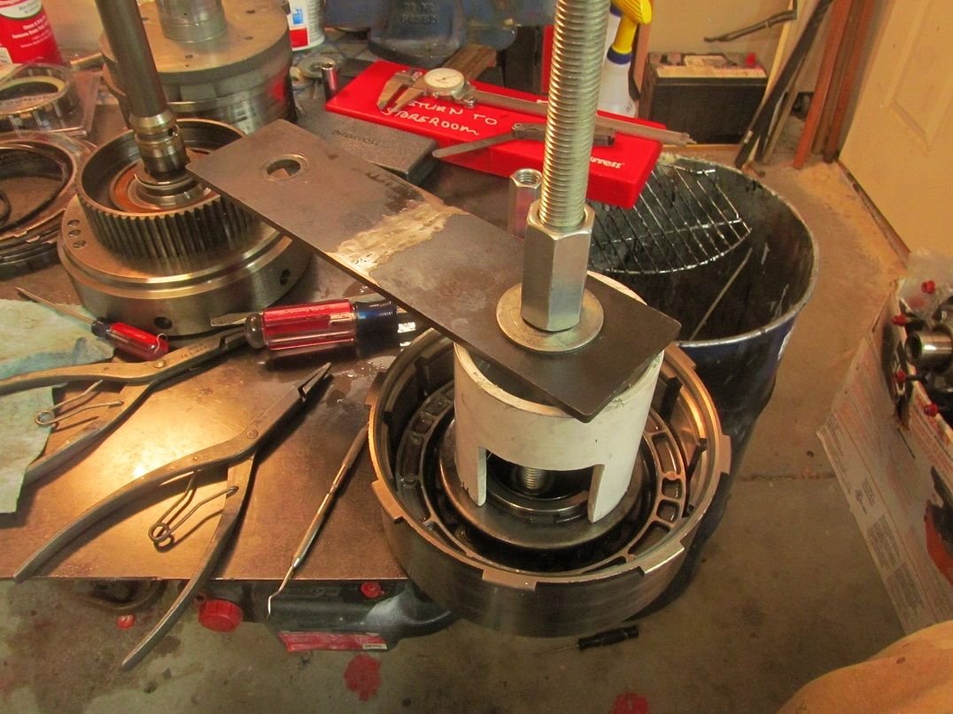

I needed a way to get the OD clutch pack apart, as you know there is a beast of a spring inside. There are a few ways to go about this, I'm sure, some of which may be a bit sketchy. I took my shop press to Canada, because that is where my heavy equipment is at. So, came up with this and built it from stuff I had laying around for the most part.
Top of my table is 3/16 plate, so I cut a notch in the edge. Drilled it for some 3/4 bolt stock. Reinforced it with some 1/8 angle and a couple of beam clamps.
Short length of 1/4 plate seemed strong enough for the head plate. Even so it bowed a bit, spring is like 7-800lbs of tension. Used a 3in Sched 40 PVC coupler, slotted to allow for access to the snap ring that holds it all together. This is the clutch pack going back in.

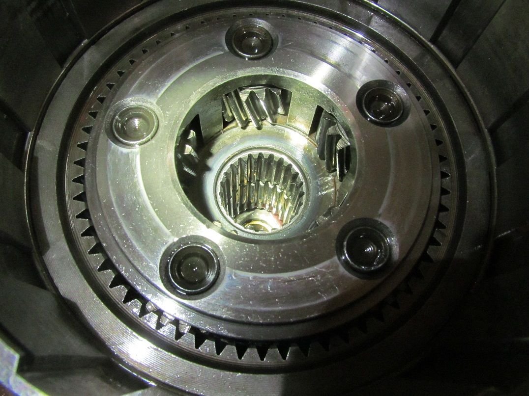

Splines of planetary gear need to be and stay aligned with the clutch shell or you will never get the OD to sit back down on the trans output shaft.

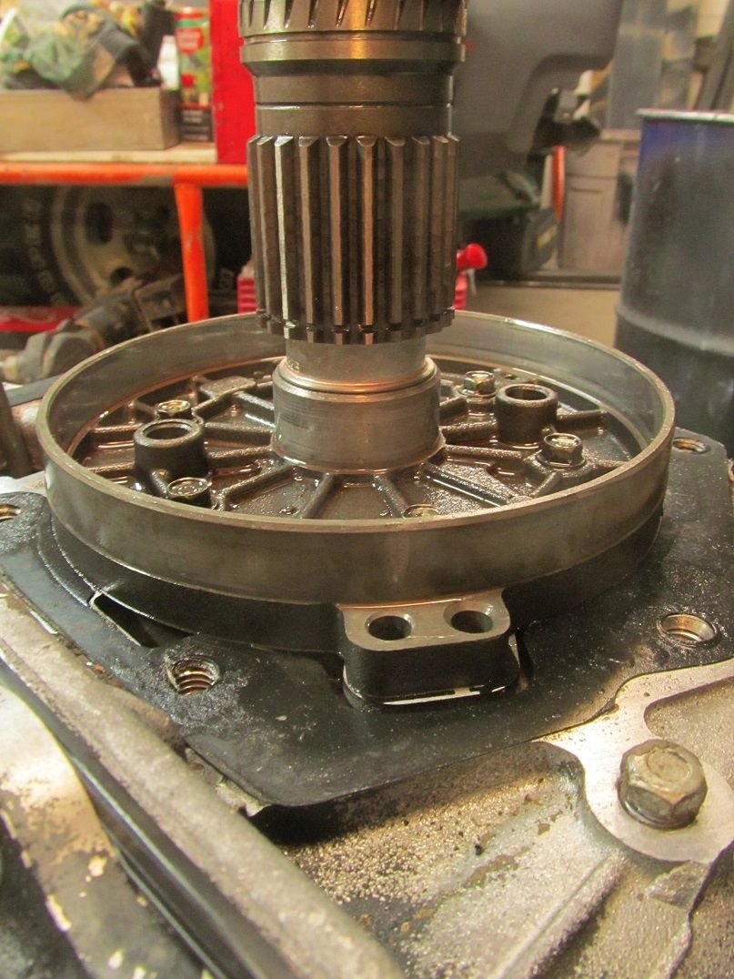

Dropped it back down on the output shaft to check it before reassembling the OD unit. OD clutch apply piston is missing here. Those two holes provide fluid pressure to the governor weights. If you have an RE these will be plugged from inside.

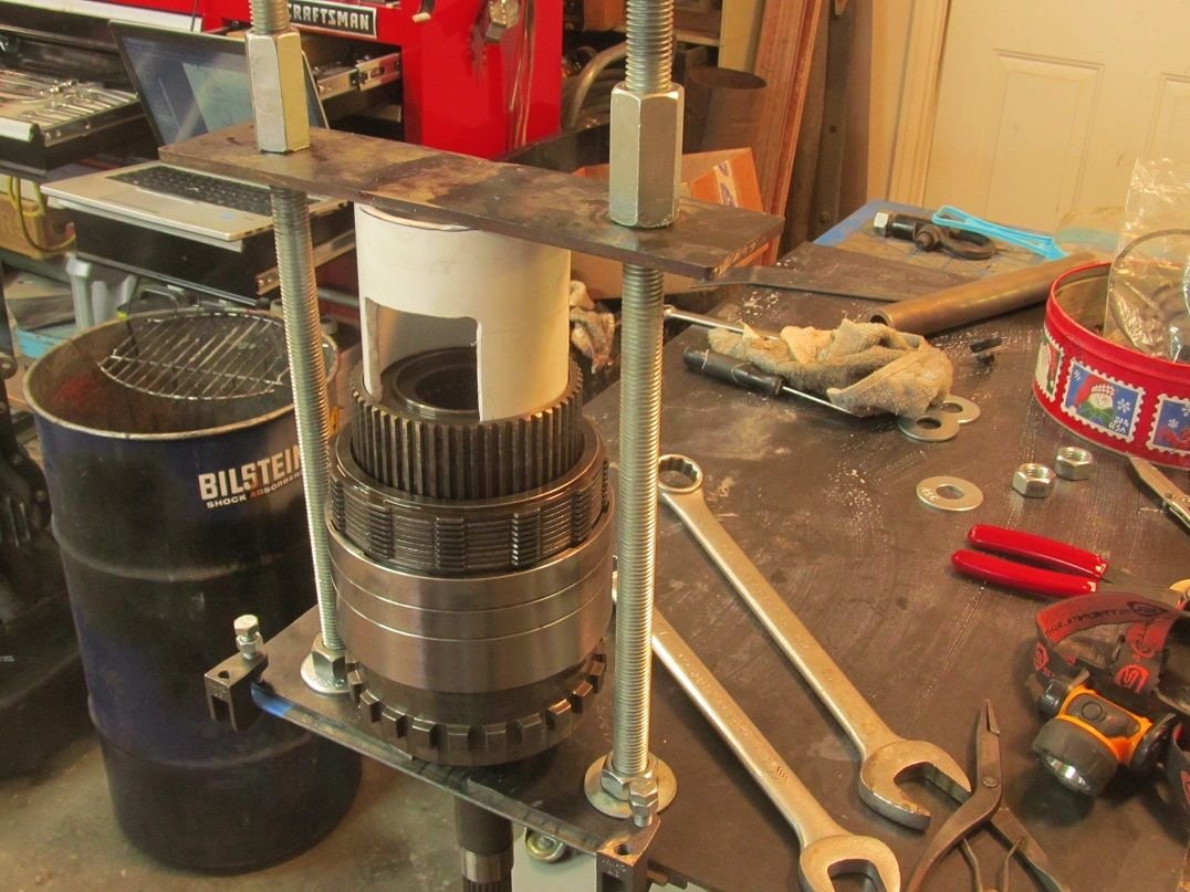

Modified the coupling in order to use it to press the rear clutch pack of the transmission apart.
Tight fit, but it works.

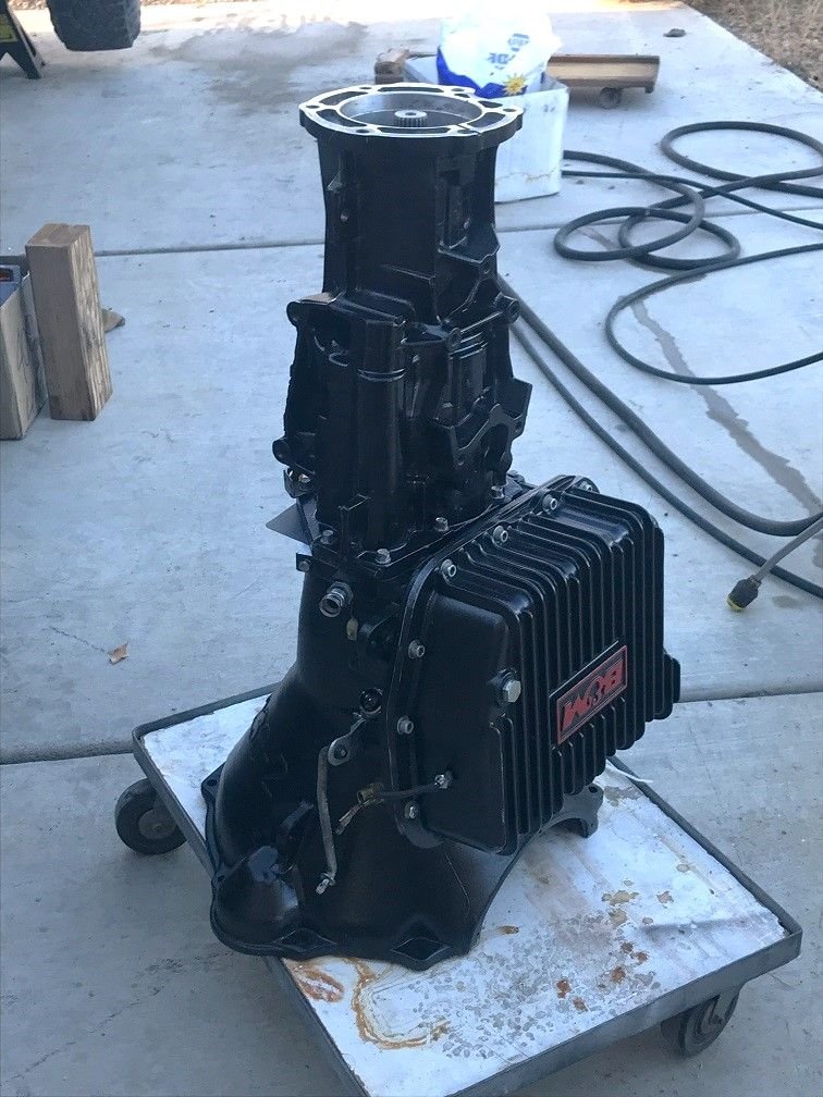

The early 47RH had a push together front fluid fitting which was known to fail in the field. The recall replacements leaked, I had to change it once. There is just enough pipe to cut and re-assemble with a compression type fitting. I drilled it out a bit for flow. Also drilled the check valve out.
As HeyYou so correctly pointed out, everything runs better with a coat of paint.
